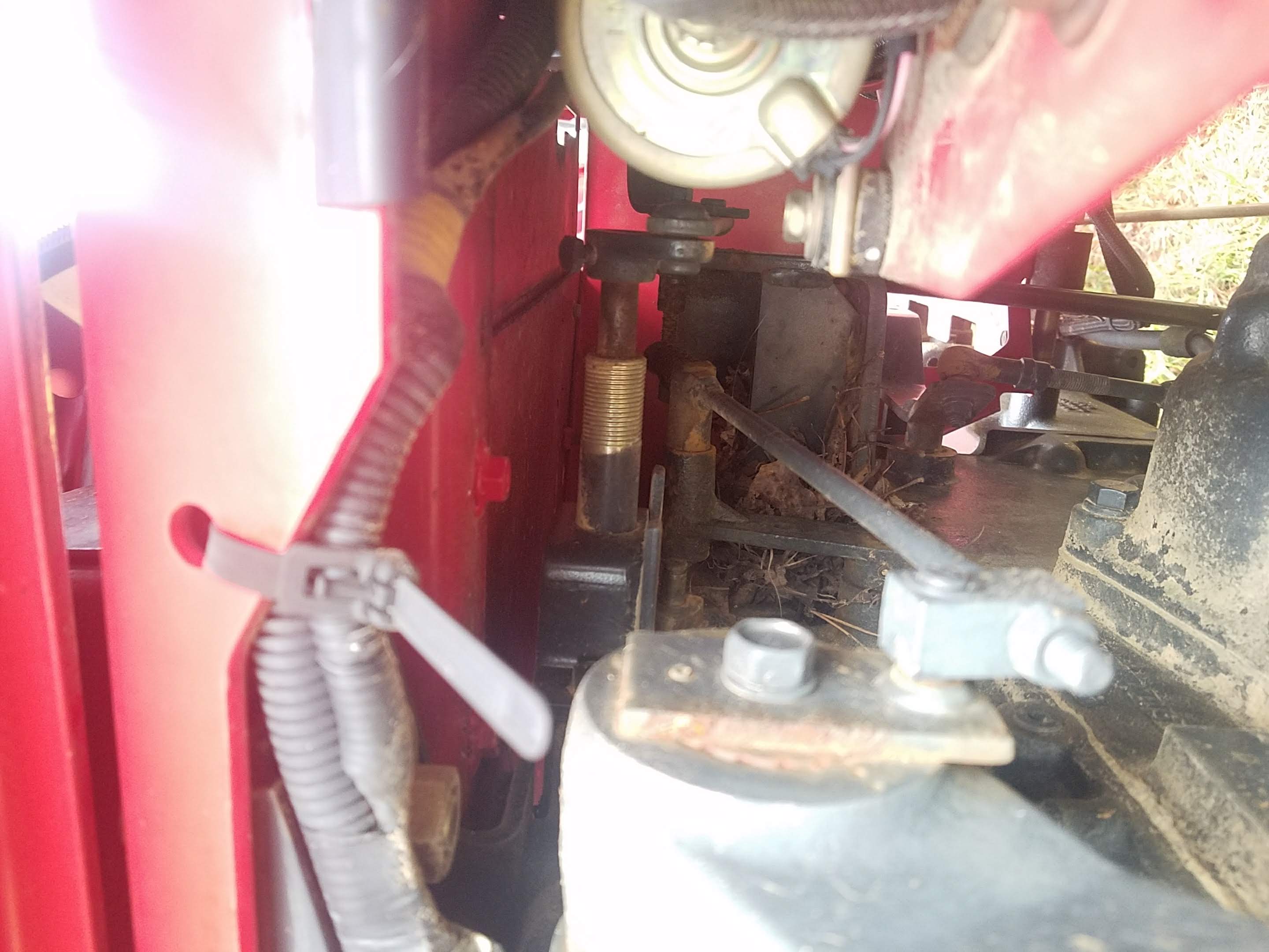

Hello all, I have a new to me 2615 gear with fel. The 3 ph will only raise about half way, I can lift it by hand the rest of the way. The fel works fine.
It seems like it is reaching some kind of limit and stops suddenly, not slowly like it is losing power. Not sure if I am explaining that well. Is there some sort of adjustment that could be off?
Here is a picture of the linkage. Does this look right? It looks like there was something on the threaded part where the paint is missing?

Look for a mechanical stop which can prevent the control lever from moving all the way. Some three point hitches have them to limit upward travel, some for downward travel, some for both.

The condition of the linkage looks as if it needs a good cleaning and lubrication.
The stops are all the way at each end of the slot. Would there be others stops?

It turned out to be a bent lever. This was a new to me tractor.. not sure If I bent it the first time I used it, or if it was already like that. I lubed everything up and it seems good now. Thanks for the replies.
