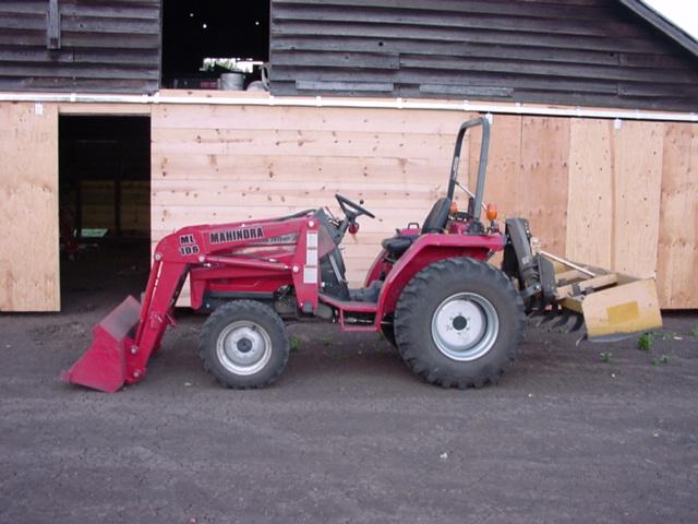

The only downside I could see is the corrosion issue. I filled with water and antifreeze because I know AF has anti corrosion properties. Fill all 4, I think if I remember correctly that the rears took about 44 gals each and the fronts 4 each. You should still keep your front ballast but the bulk of the tire weight will now be under the axles and it will make a major handling difference. One thing you can do is find a local tire shop that does alot of tractors, they will be able to tell you what they use most frequently. Good Luck....

I would say the 2015 might be just the right tractor for what you want. They look pretty much like the 2615, but smaller. The thing that got me thinking 2615 instead of 2015 was they are just a little too small -- in terms of height -- to handle a PHD very well.
