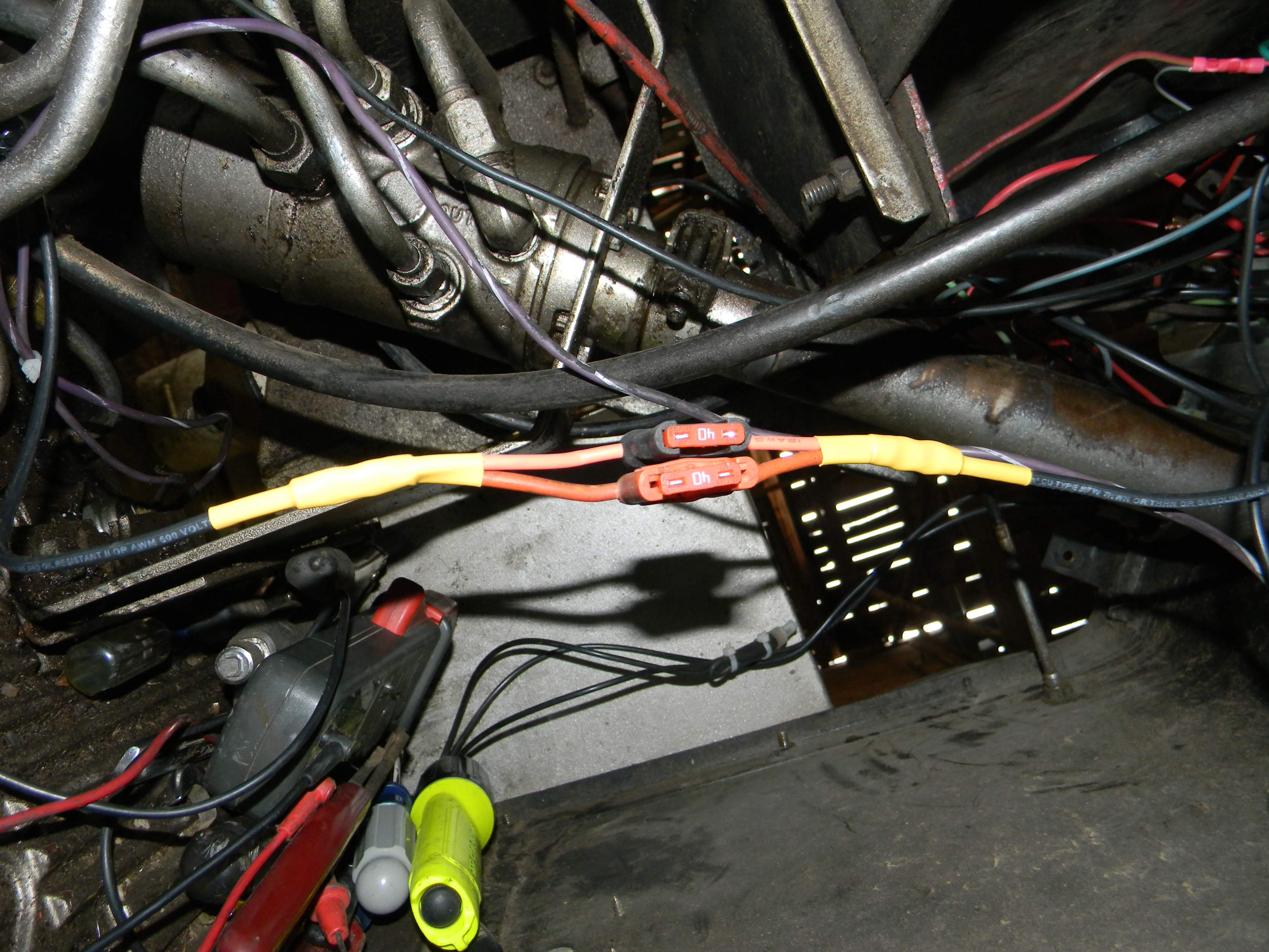

OK, I took the alt. to the shop this morning to have it tested and it was doing the job it was made to do. The shop guy told me the new alt. put out around 65 amps compared to the old alt. that put out only around 32 amps or so. Here is what he wanted me to do. Tie 2 - 40 amp fuses parallel to each other in the line coming from the battery stud on the solenoid going to the amp gauge. I spliced the 2 -40 amp fuses parallel with each other and heat shrinked the splices. After doing so, I have run the tractor for a while idling and and at higher rpm's and everything functioned as it should. The fuses are holding and there is no heating up of the wires in the circuit. Well there's another one fixed. WOOHOO!
Thanks All!
