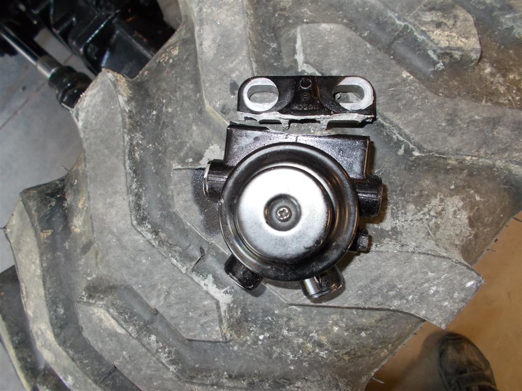

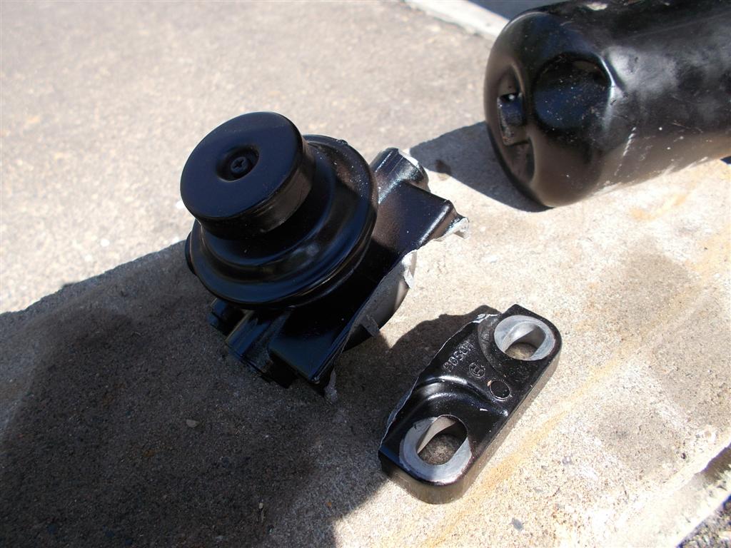

I have a new Mahindra 2655 with 22 hours on it now. A little mishap pushing some brush and branches. A branch popped up just right and took out my fuel filter assembly. It hangs down low on tractor with no protection.
Does anyone or dealer know where I can get a Fuel Filter Head assembly for it? Mine busted off where it attaches to a bracket that attaches to engine. Part # 006008906B1 that is stated for it isn't the right one for my 2655. The spacing on mounting holes are only 1 inch and 1/2 on center & mine are 2 inches on center. Mine also has 4 ports with only 2 used. New part has 2 ports towards the front. Thank you.

Mine is a 2655 Gear no cab. The difference is the mounting hole spacing as stated in first post. Mine 2 inch on center other inch & half. Picture shows mine which is different from actual listing for mine. Thanks

It sure looks like to me that the holes are slotted to accept the two different bolt spacings.
   / 2655 Fuel Filter Head Assembly Broke
#9
Bolts holes are slotted but still misses by a half inch. Came up with a used one(006008906B1) that was suppose to be for mine. Had to drill out holes since it used smaller bolts. Could only mount with one bolt as other hole completely misses. Will work temporarily until I find original head. Could drill out mounting bracket on tractor maybe but shouldn't have to on a New tractor. Sure am questioning Mahindra's if you can't get the right parts for them.
Can't understand why I can't get the right/same part that came on my new tractor. To ruffdog the slotted holes are on the head itself of my broken part but the mounting bracket on tractor are not slotted - they are a fixed 2 inch on center so a new head has to be the same. Part needed that came on tractor is a Bosch F002H20159 which doesn't seem to exist anywhere. Mahindra's???
