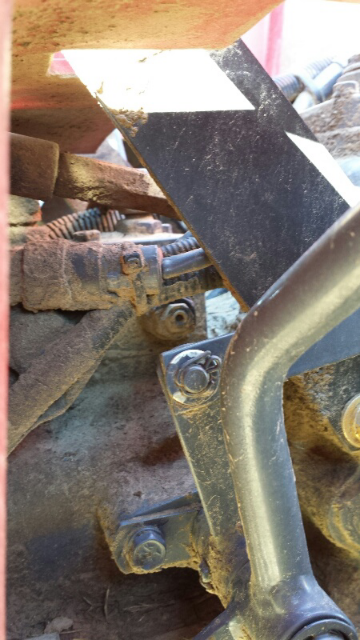

   / 273 HST backhoe-----Where's the regulator to increase pressure? #7
Well this is going to test my memory but I think JJ hit it close on his post. As a matter of fact I think he helped my back in 09 too. Anyway I have attached a picture from underneath the drivers side rear tire. Right in the center of the picture you will see the a nut with the hex center. I believe that was where I made the adjustment.
   / 273 HST backhoe-----Where's the regulator to increase pressure? #8
Thanks for the info. I am familiar with the screw in the picture. Digging deeper into the memory bank did you measure the pressure before and after you made the adjustment or was it a case of giving the screw a small say 1/4 of a turn and test the performance?
However you went about it did it make a big difference to the digging force and is it still the same today?
   / 273 HST backhoe-----Where's the regulator to increase pressure? #9
I did measure the pressure before and it was 1800psi and after it was 2300psi. You got it, I slowly turned it like you suggested and re-tested.. As far as if it is still that today, I don't know (but will go check :) As i recall it did make a difference in digging force that was noticeable but I haven't used the backhoe for quite awhile. Will have a project for it soon though.
