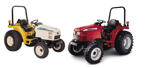

Speaking of rebranding, see my attachment. I have the 2615 which use to be the Cub Cadet 7265. I believe all of the 15/16 series use to be in the Cub line. Also I am under the impression the entire tractor minus loader valve and loader are mitsubishi.
Same here with getting my tractor to heat up to the green line. It takes awhile and when its 0 or colder it won't reach the green line unless I"m working it.
Matt, you are correct regarding the Cub Cadet. It is my understanding, when MTD bought Cub Cadet, Mitsubishi didn't want to continue the relationship. Therefore, the new CC CUT is Yanmar built.
Mahindra made a very smart move in adopting the Mitsubishi built models. I couldn't be happier with my 2615.
