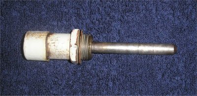

I helped a friend bring home an old 2N today, made in 1945. It's not running but was a couple of years ago. My question is there is a part missing but we don't know what it is. It mounts below the battery into the top of the transmission case. You would see it from the front looking below the battery. You can see into the top of the transmission case through about a 1" hole, and there are two bolts or stud right and left of the hole, maybe 1/2" in size. You can see the outline of a gasket where something was bolted there, sort of oval shaped. Does anybody know what bolted up in this spot? Sorry, I wish I had a picture.
   / 2N question #3
starter soleniod bolted there orignally
SWITCH!!!! no solenoids on a 9n / 2n!!!

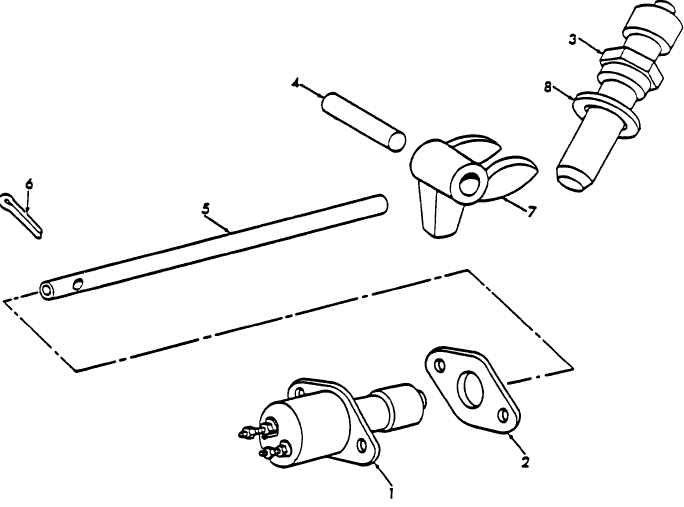

here's a pic of the plunger switch in the trans cover and a diagram, plus the parts listing.
part number 1 is the SWITCH that goes in the back of the steering column
1 1 9N11450B SWITCH Switch Assy., Starter Push, BSN 12500, 9N, Not Serviced., Years: 01/01/1939-12/31/1940
1 1 86531629 KIT Kit, Switch Assy., Starter Push, Refer to Service Bulletin 96/11-T5, Years: 01/01/1940-12/31/1947
2 1 9N11467 GASKET Gasket, Starter Switch, Used W/9N11450B, No Longer Serviced., Years: 01/01/1940-12/31/1947
3 1 9N11506 BUTTON Button Assy., Starter Switch, Years: 01/01/1940-12/31/1947
4 1 NS NOT SERVICED Rod, Starter Push Lever, Years: 01/01/1940-12/31/1947
5 1 9N11512 Rod, Starter Push, No Longer Serviced., Years: 01/01/1940-12/31/1947
6 1 PL PROCURE LOCALLY Pin, Cotter, 3/32" x 5/8", 9N,2N, Years: 01/01/1940-12/31/1947
7 1 NLS No Longer Serviced Lever, Starter Push {2N11515}, Years: 01/01/1940-12/31/1947
8 1 B12410 BEARING, CUP Gasket, Starter Button to Housing, No Longer Serviced., Years: 01/01/1940-12/31/1947
