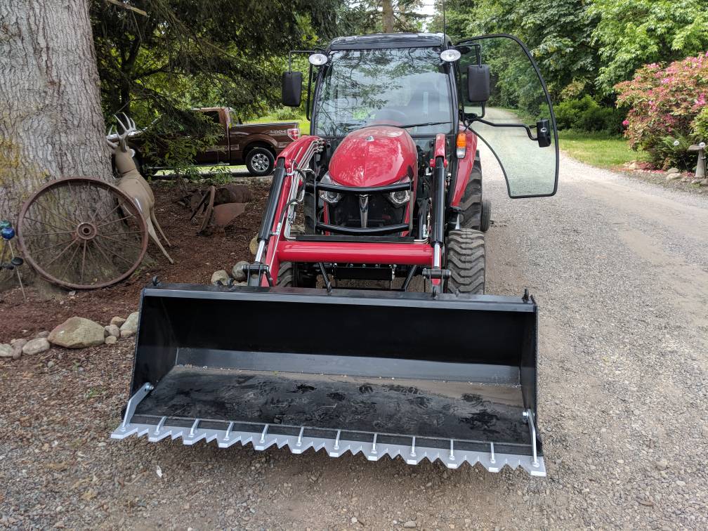

First I added Pirana Teeth to the bucket cut blade. Have to say it is great. Install is easy and it fits solid. Works great getting rid of black berries and as a rake to back drag them up into a pile to scoop.

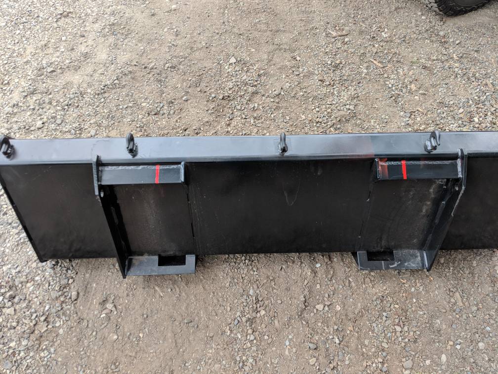

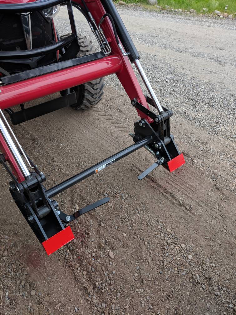

Second I painted to top of the skid steer bucket attachment red and red lines on my implements to make line up easier. Before everything was black and hard to see for line up. Could be old age setting in. With the cab your only window to see for line up is between the hood and the FEL arms. This makes it a snap. IMG_20180603_122910.jpegIMG_20180603_122848.jpegIMG_20180603_120611.jpegIMG_20180603_120621.jpegIMG_20180603_120822.jpegMVIMG_20180603_120842.jpeg

Nice! First time I’ve seen a piranha tooth bar on a Yanmar. Did you weld those bucket hooks on too? Or did the dealer do that?

I am also getting one of those Pirana Teeth bars for mine, glad to hear it is working well for you.

The dealer installed those. Only wanted three but they didn't put them where I wanted them.

I like your red/red line idea. Thanks for sharing that; I may just employ that technique or something similar.
