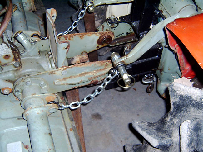

Has anyone converted a 2 point tiller to a 3 point? Is this possible? I love my 2 point tiller, but it sure would be a lot easier to hook up if it were a 3 point.

Yes, some have done it. I am planning the conversion for mine, but it is down in the que pretty far right now. I agree, attaching that 2pt tiller is a pain. It shouldn't be too difficult, but will require a different pto shaft, and I don't know if the tiller end is a standard size/spline.

What part do you find to be the biggest pia? For me, it was the lift arm pins. The 3pt requires rigid pins and the 2pt tiller uses removeable ones. Instead of using the rigid lift arms that came with my tiller, I replaced them with a length of chain. I then used a bow clevis on each end which fits over the pin. I needed to file a bit of the flash off the bow to get it to fit right. Now the bow slides right onto the pin and is retained by the existing snap clip. The tiller shows no signs of kicking up which was my concern when I initially made the conversion.
