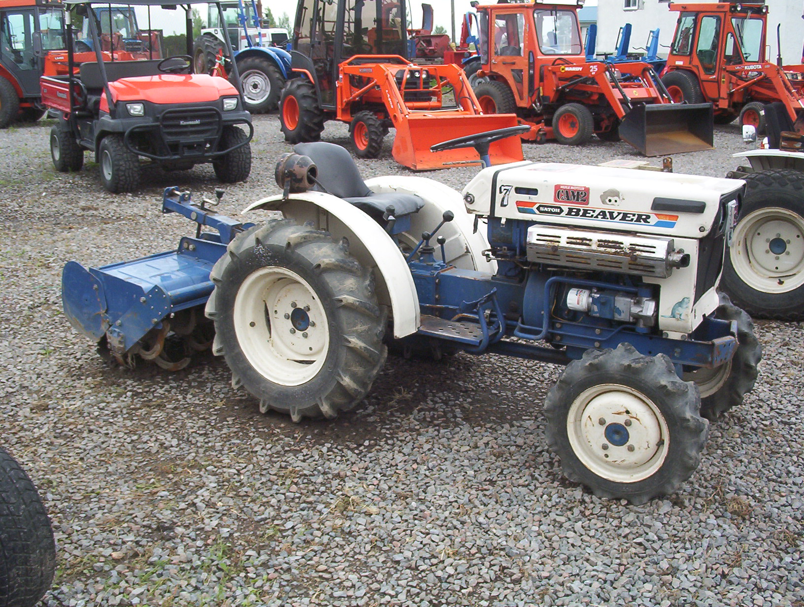

Just curious, Has any one found and easy swap for the 2wd front axle on the beaver? Looking for one that would be adjustable tread.

unfortunately unlike the 4wd's, the 2wd front wheels are centered

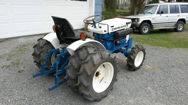

Well I find the Beaver a lot more stable with the rear wheels flipped out for the wider setting, would like the front to match up too. Was just wondering if any of the other Mitsubishi tractors had an adjustable axle that would be an easy fit on the beaver.

The 2wd have and odd 3 bolt pattern... I thought about making spacers but its so hard on the pinion and bearings, not sure I want the do that to a 30 year old axle. I think I need to tough it out or get creative and make and extendable axle from scratch using an original and chopping it up. just need to find one for cheap
