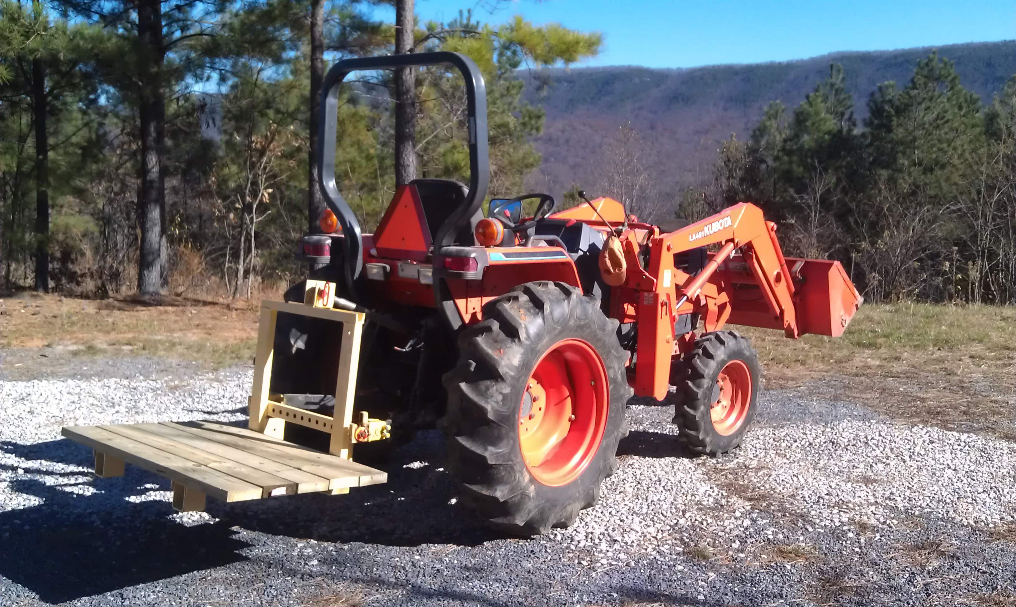

Happy Bird Stoney Point,
I solved this problem last year by purchasing a sprayer at BASS PRO SHOP. Don't remember if it is a 35 gal or a 50 gal. Anyway I mounted it on my 3pt hitch "carrier" that is approx 3'X4' press treated deck over steel frame that I built to carry firewood. I STRAP the tank on the carrier, spray my mile long road and the edges, round-up my food plots for replanting in the spring then flush out and remove the tank for firewood duty when I don't need it it. Just a thought, good luck.
