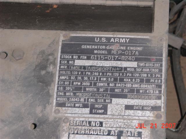

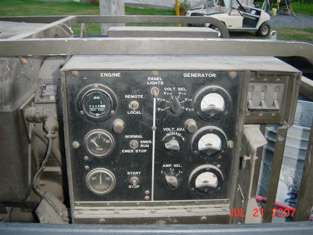

Finally got it. Here's a couple pics.

very cool! were do i get one! :)
   / 3 phase gas generator uses
Knowing the right person is what worked for me. I guess there's a lot of these around in municipal or state buildings and garages. This one was mounted in a ceiling in one and the insurance inspector told them to get rid of it, so they did.:)
