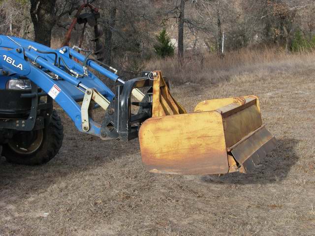

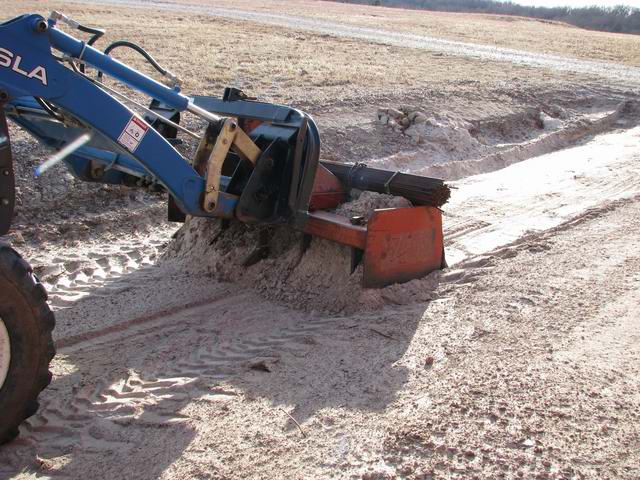

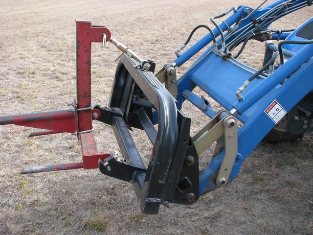

There are many examples of adapters that are available. Here are two of the best. Having adjustable attachment points for the lower links makes your adapter much more flexible. I have one without the adjustment and some of my 3PH implements won't fit.
I've attached a few pictures of mine.
