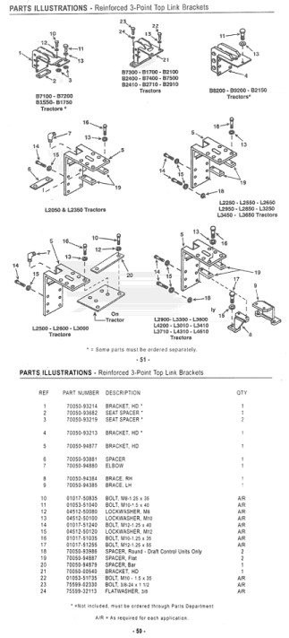

Does anyone have a 4690 A or B backhoe attachment on an L-series tractor? I have a chance to pick up a used 4690A and use it on my L3540 cab tractor. Has anyone used this backhoe on an L-series? I am thinking that the larger frame tractor will not have the problem with the weak toplink bracket and I would not have to worry about damage or cracking. Anyone have an opinion? Also, what is the difference between a 4690A and 4690B ?

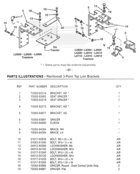

The only torn out top links that I remember seeing were L series tractors, That is what kept me from getting a 3point BH. If you check I think you will be able to come up with the appropriate top link reinforcing kit like the attached breakdown for my L4200 cab tractor. Even with the kit I do not think a 3point BH is a good idea. KennyV.

I tryed to get a renforced top link a few ago and my dealer assured me that Kubota had made changes in the base metal that holds the bolts and the bolts also. He assured me that I would have no problems.I have a 3PH skidding winch that I built and it has a 10,500 lb winch on it. This is where my concerns arose.

Still no go... so lets give it one last try.
you know the saying about the third try...

Deerlope, I sure hope your dealer is right,
there is no reason any tractor should have been made with a week top link.
The memory of the pictures of the torn away top links has kept me from really loading that point on mine. Those pictures must have been so bad I did not save them I am still trying to get those images out of MY mind. KennyV.

it looks like even the L4610 had a weak link. I thought that the larger tractors were strong enough. Maybe I should bite the bullet and get the BH90-X that would work with my tractor....
