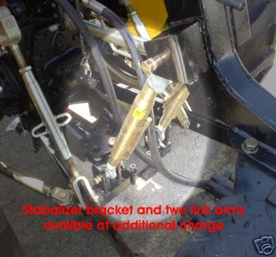

Anyone know where I could buy this 3 point backhoe bracket for the LW-6.

That looks like an anti-lift connection to the drawbar. It seems to
use 2 standard cat 1 tolplinks to keep the 3-pt from rising when the
b/h pushes down. That should be very easy to fabricate locally.
