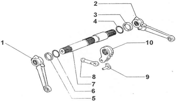

Having a hard time finding this info on the net. All my searches turn up ways to use a 3 point, how to hook up an attachment. I'm curious what internal mechanism rotates the lift arms? Does anybody know a link to a diagram showing the internal mechanism?

Try this. It's pretty typical.
3 Point Hitch Cross Shaft Parts
There are several ways to make a three point hitch, but generally you use a cross shaft that, when rotated, raise the lift arms. How you rotate the shaft is somewhat variable, but generally you use a hydraulic cylinder to push on another arm in the center of the shaft.

Thx Kenny.
I assume a simple hydraulic cylinder pushes on the ball at part #8?

Essentially, the 3pt piston rod pushes on a lever mounted on a shaft which has two lift arms attached.
When fluid pushes against the piston, the connecting arm causes the shaft to rotate and the lift arms to raise.
When the fluid is allowed to escape to tank, the lift arms descend and the piston retracts.

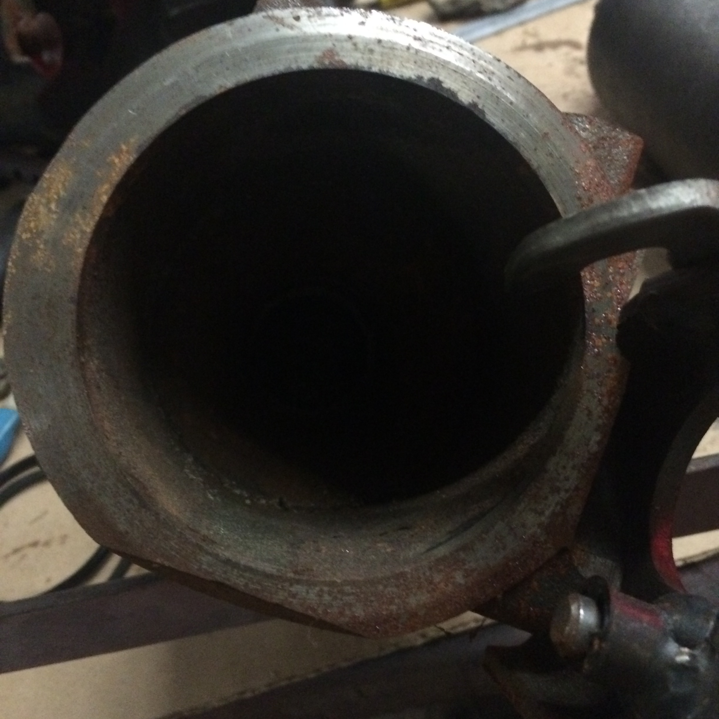

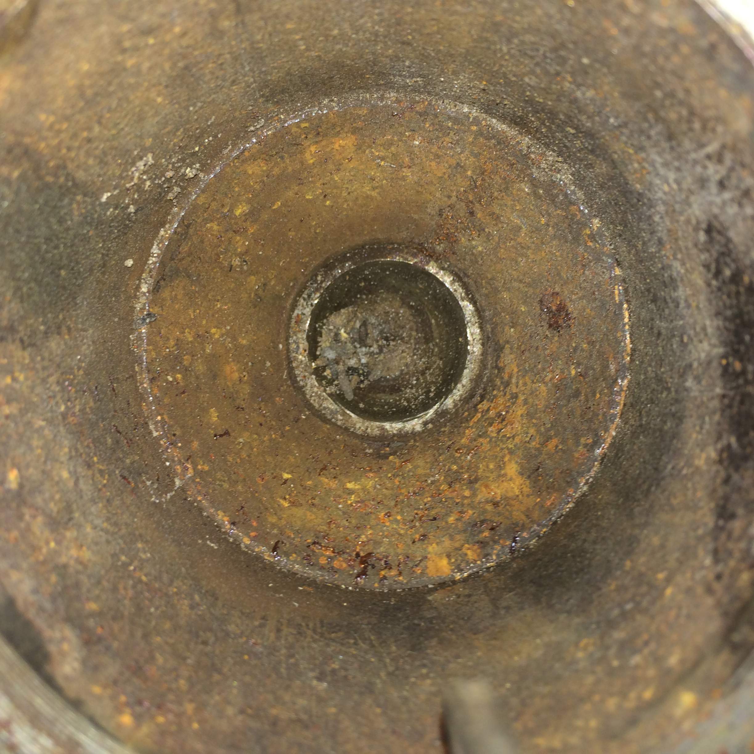

I just happen to have one apart in my shop now with a stuck lift piston. I will say, this is the worst one I have ever seen. Per the owner, the tractor has been setting up for around three years, but I'm thinking he might be off by a few years.
I gave up trying to get it out as it's junk anyway. I pick up a good used one to replace it with.

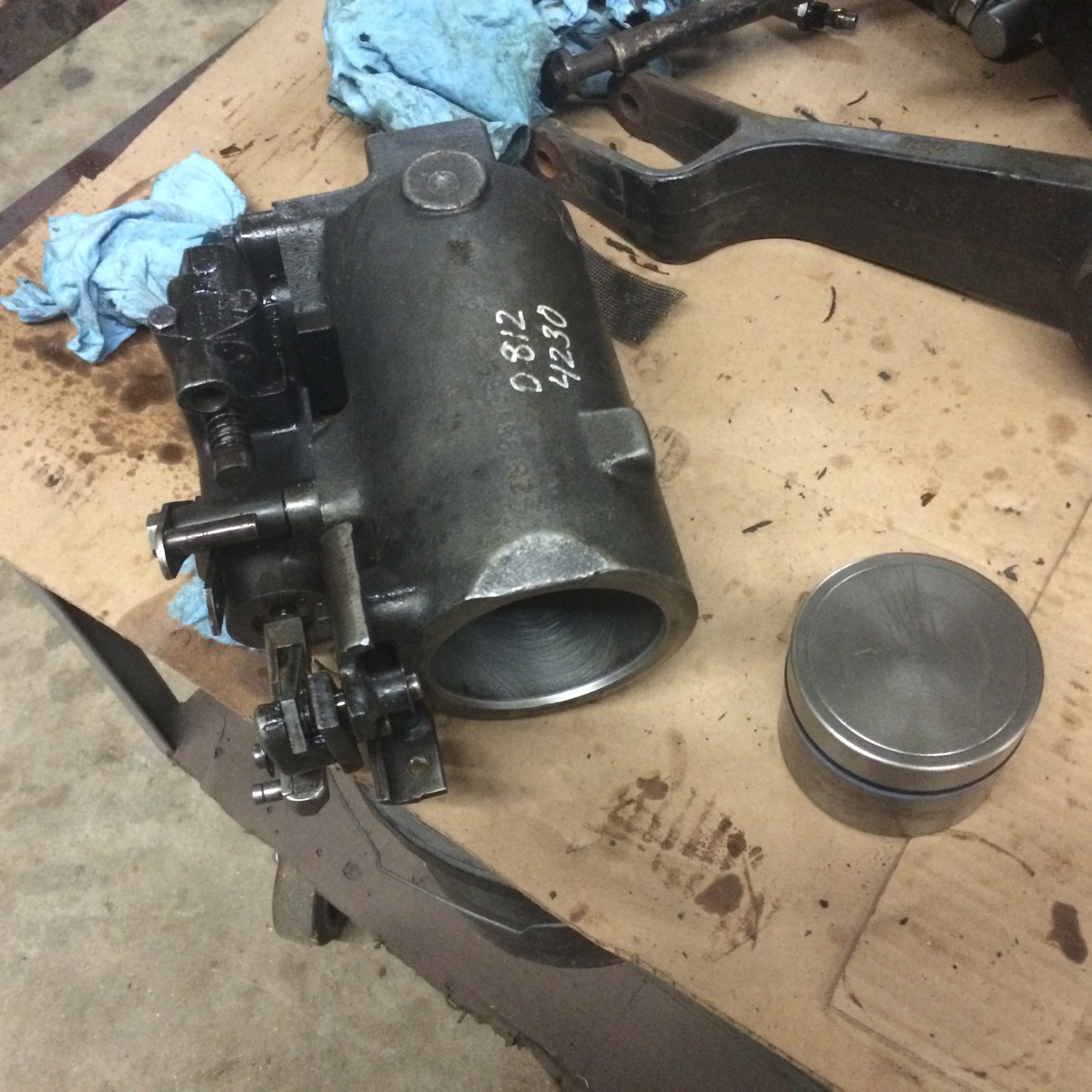

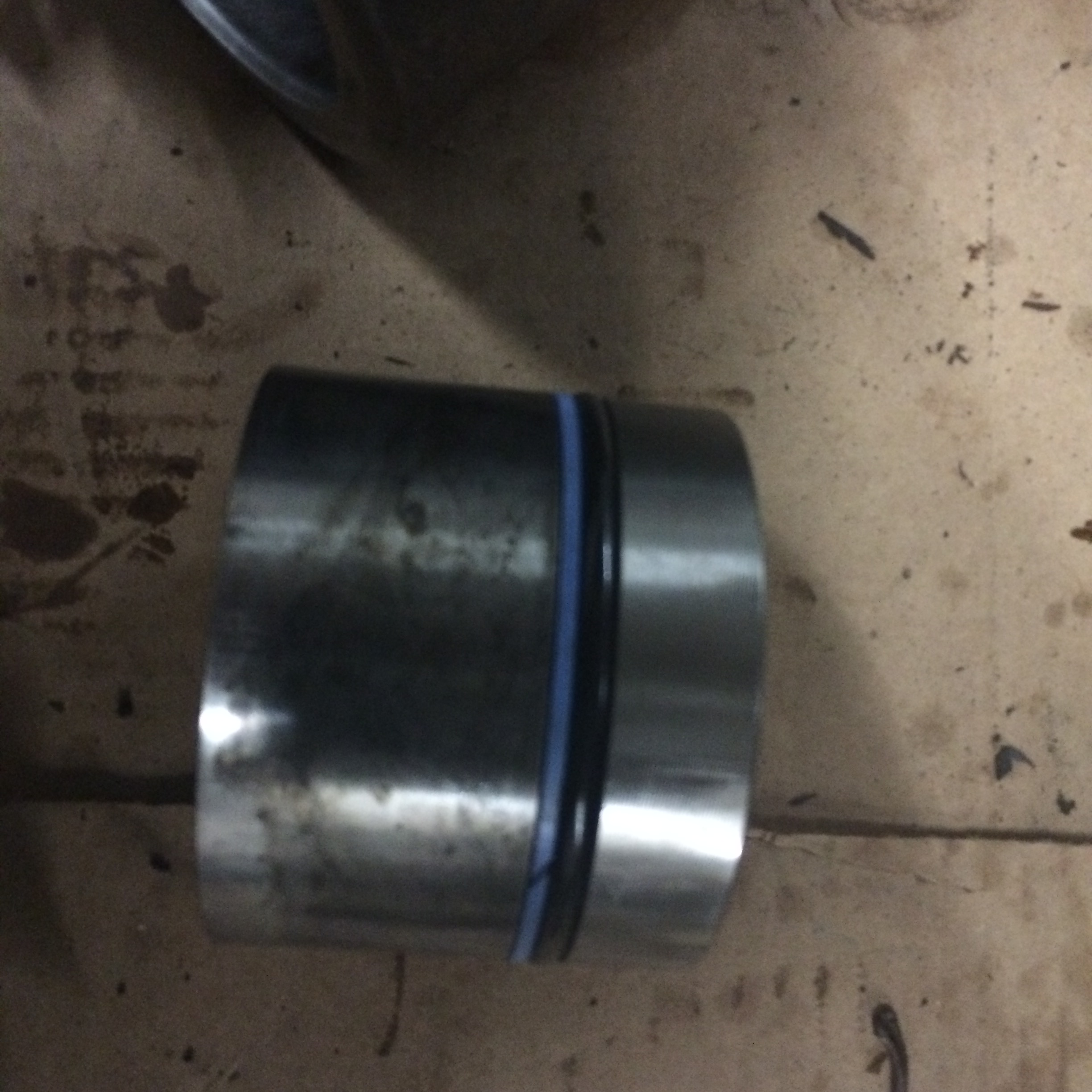

No diagram, but here are some other pictures of the internal lift parts on a CaseIH 395. Hopeful this will help you.
Lift cylinder and control valve. Piston removed.
Lift cover with cylinder removed

Piston with new o-ring and backup ring.
