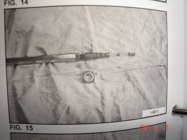

Hello,
New to the forum. Just purchased my first tractor, a 2006 MF GC2300 TLB. Got on it tonight to move some more snow and I broke the 3 point hitch speed control knob. Must have kicked it climbing through the seat. It broke all the way back at the stuck so the whole shaft came out with the knob. Anyone else ever have this happen and if so, how big a job to fix. Too cold tonight to get back there and look.

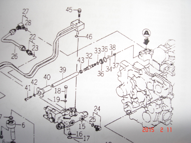

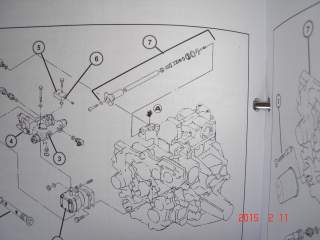

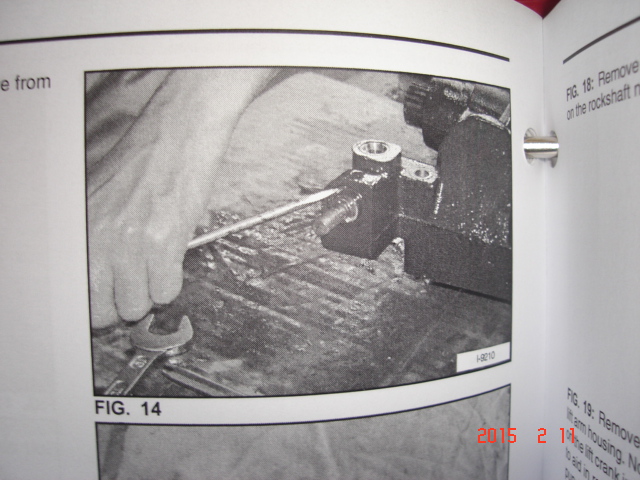

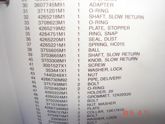

It's called a "slow return valve," and it appears that it's held in with a snap ring. Sounds definitely like a warm-weather job to me!
Parts are from #32 to #42, inclusive. (Don't lose the little ball & spring..)

Thanks a bunch. This is very Helpful. I agree with warm weather job. Have to be a little more careful climbing around on the tractor from now on. I see you are in New Hampshire. Any suggestion on where I can order parts for this machine. I do not appear to have a MF dealer within easy driving distance. Been browsing the forum and would like to put a filter guard on it as well.
