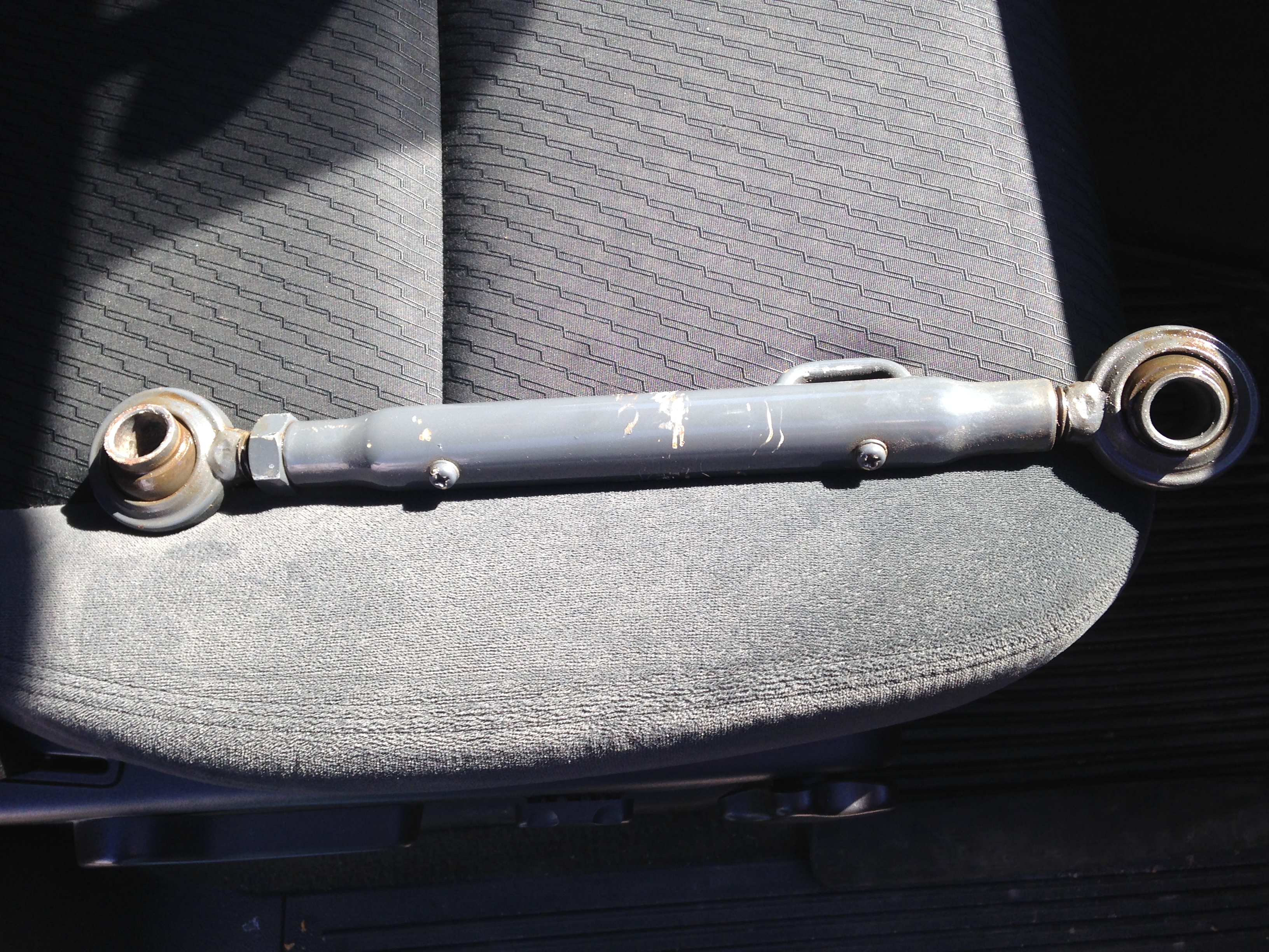

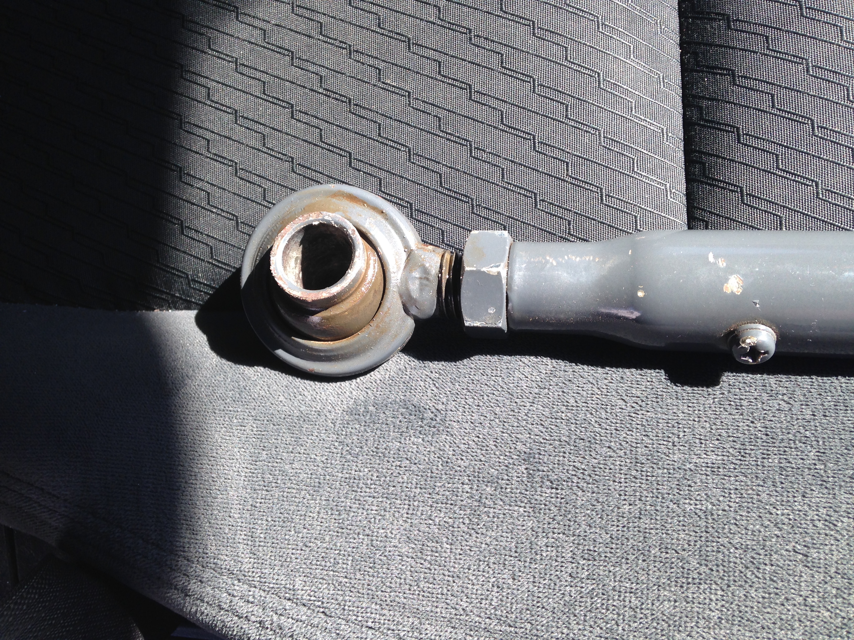

I am using my box blade and need to shorten up the top link a little bit more to get the right level on my box blade. I have it as tight as it will go, but there are a few more threads that I can't seem to use. See pics. Do the two screws in the side have anything to do with this? I cannot get them loose for the life of me to try it out anyway. Thanks

The screws don't have anything to do with it. You have likely reached the minimum length, and the two threaded rods are butting up to each other inside the tube.
Assuming some other adjustment isn't off, you might need to buy a shorter top link. I'd really like to see a picture of the whole arrangement to see the overall geometry though.

The screws are just there to plug the two holes in the tube. The holes are used to install pins into the threaded rods so they can't unscrew all the way out.

What i have done in the past was shorten them myself. If you are careful you can grind, and taper the threads alittle. Just move the jam nut all the to the end, unscrew the rod. Then grind a little off both ends, not more than an 1/8" from both. Magic:drink:

The OP has a OEM Kubota top link. The ends won't screw all the way out because of the pins installed on the ends through the little bolt holes as S219 describes.
The best solution has already been mentioned...buy a shorter top link from Tractor Supply or similar.

I went to Fleet Farm and Tractor Supply and all the top links were too big. I got home and tried to unscrew the rods on the top link all the way to cut them shorter, but they got hung up on the ends and would not budge. So I tried to take the screws out and ended up putting the link in a vice and whacking the screws with a hammer and phillips screwdriver, which did loosen them up. I then tried to unscrew the rods and still no luck. So I screwed the pins just back in far enough to peer through the open screw hole and saw they peened the end of the threads to keep them from unscrewing too far. So as a stubborn ironworker, I decided that was surmountable. I unscrewed the rods as far as I could and lubed the crap out of them while turning them out with a long pry bar (piece of rebar) They did come out, and I promptly cut the ends shorter. Fixed! Thanks for the tips.

One our Kubota OEM toplink, the screws are also the weep holes for the grease which gets forced out when we screw the posts in.

You likely don't have to re-peen the threads of the OEM top link. Aftermarket ones can be screwed out with ease. It is Kubota's lawyers with a CYA feature.
Another option, since you are mechanically inclined, is to buy an aftermarket top link and cut out a section of the body. Then weld it back together and you have a shorter top link. I had to do this to mine for a foreign-made flail mower.
Note how far the threads go in to full depth first, otherwise the ends will hit and limit the depth. But, as previously posted, the threads can be carefully ground off for an even shorter top link.
