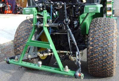

I did some research and have recently noticed that the local TSC posts the Cat 0/I dimensions. Width on Cat 0 is 20" between arms. Width is 26" on Cat I. Bottom pins on Cat. I are 7/8". Top pins are 3/4" on Cat I and 5/8" on Cat. 0.
Official ASAE specs for center-to-center distance from draft arms to top link is 15".
Checked all this out when I bought the stuff at TSC for my drawbar shown here. Wanted it to fit onto a QH in case I ever bought one.
