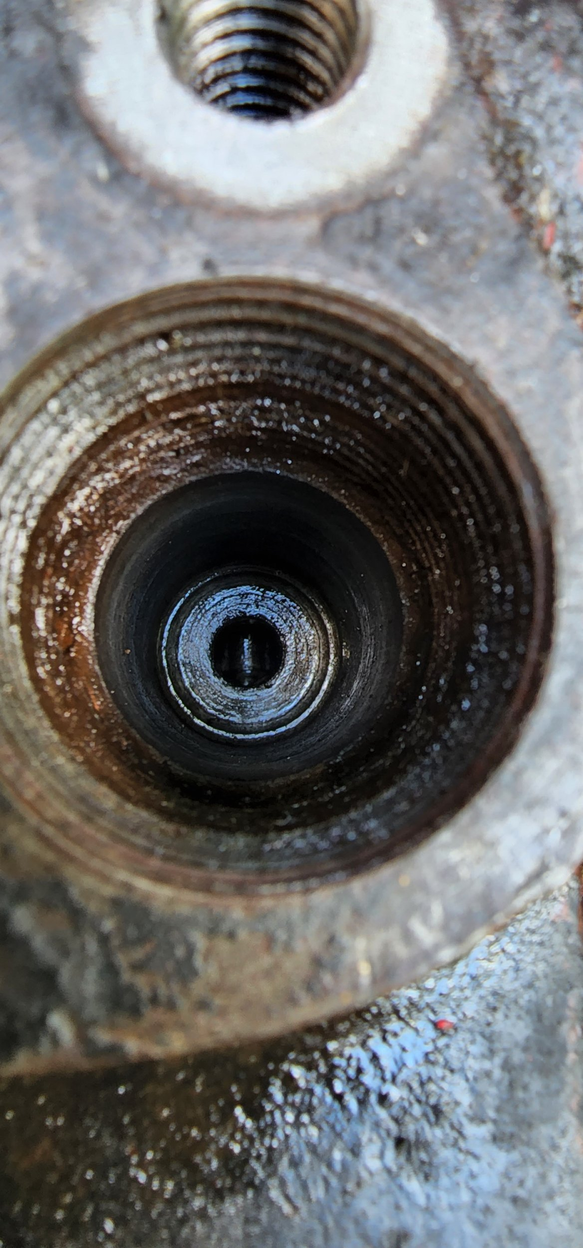

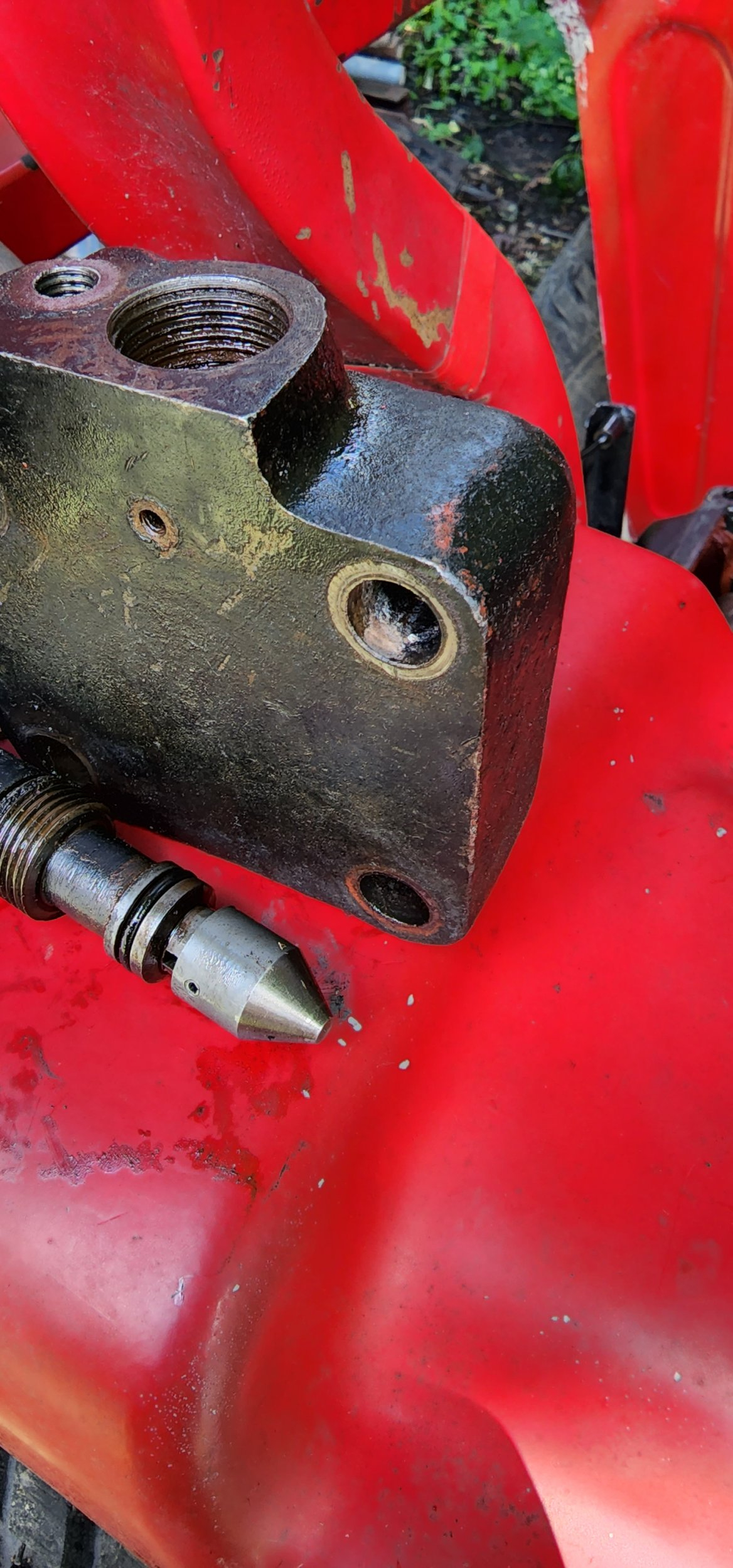

Help, jinma 284 3pt not lifting. Steering and front loader work as expected. Pressure relief valve has been inspected. Cylinder piston inspected, seals all look good. Valve between legs has been inspected. Only question there is I would think the seat would be tapered or beveled to receive the cone shape valve. No leaks

   / 3 point hydraulics #5
No worries. If you ae concerned about it not having a matching bevel, using a tapered plug into a round hole makes a common inexpensive high pressure seal. It has less area to catch crud. It wears out quicker, but cheaper to manufacture and easy to fix.
