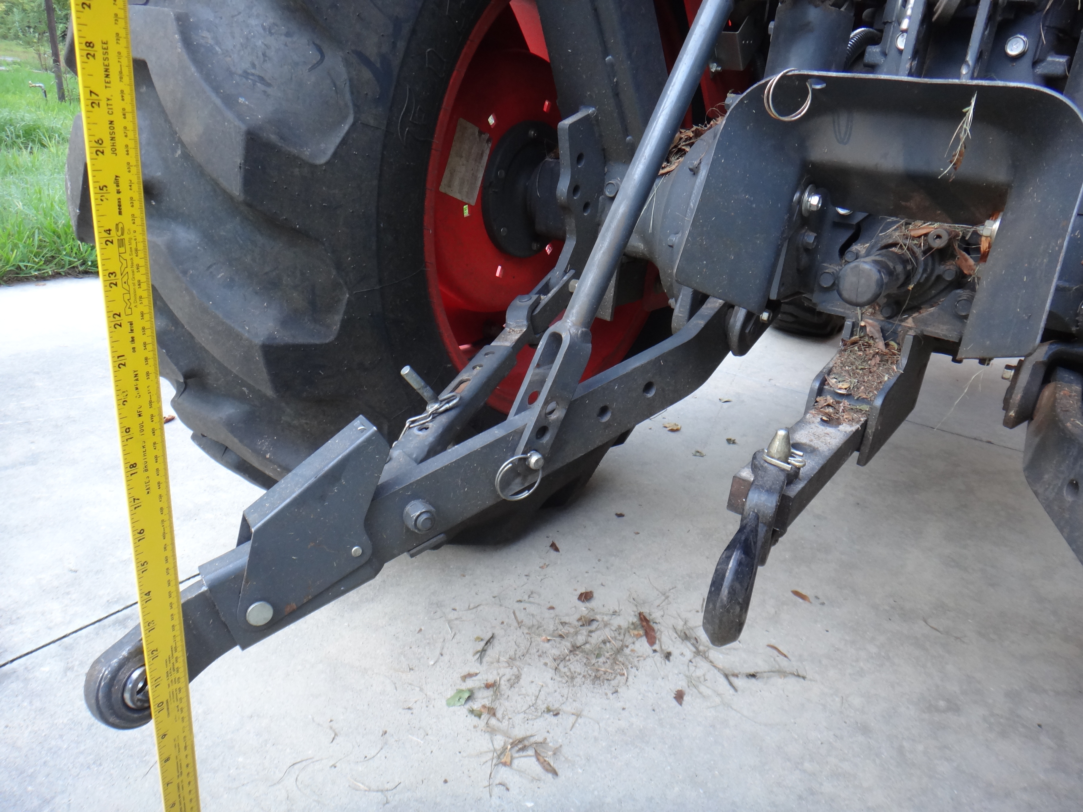

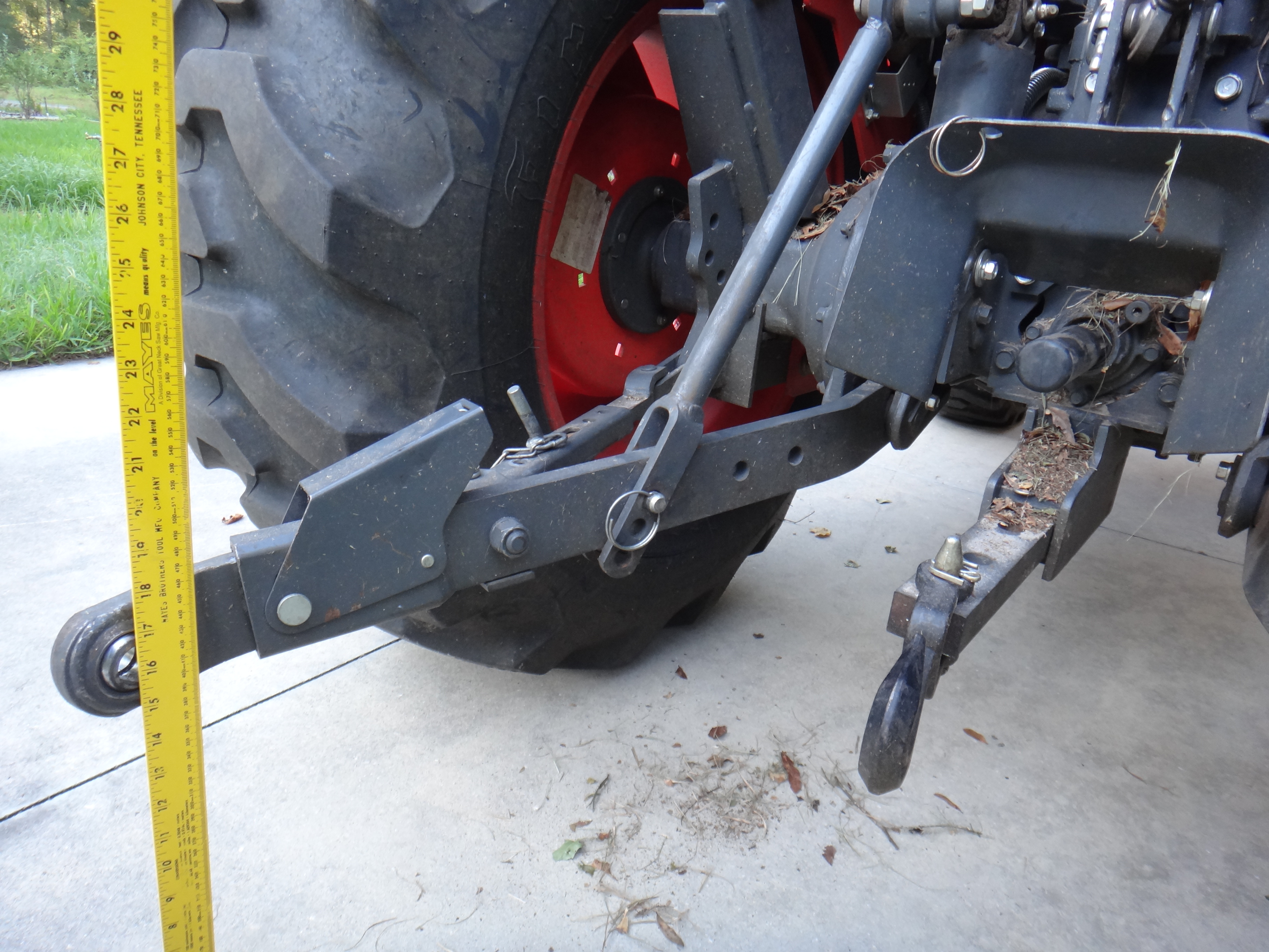

First off thank you for checking in on this post/question. I own a Long 510, the 3 point arms will go down to about 6" from the ground at the rear joints but will only raise to just shy of parallel to the ground. In moving the control lever from the rearmost position going forward it will raise to a point then will start to lower after hitting the max height. Owning a tractor is fairly new to me and I am wondering where to start looking? I have been a mechanic most of my life and did a short stint as a agg field service mechanic but have not had much time on 3 points but as I recall they should raise quite a bit above parallel to the ground. Any suggestions where to start looking? thank you in advance for any advice.

Does your Long have the Lower Links connected to the Lifting Rods with adjustable pins going through stirrups? Lift changes about 6" at the bull's eyes.
Photos of adjustment by moving pins.

Jeff, links are as far up as they can be.
