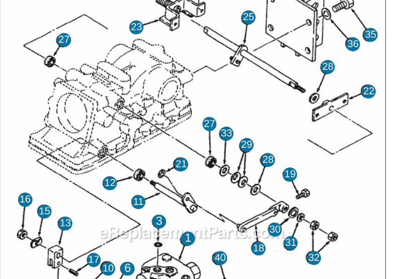

I also have a 7305 Cub Cadet that the 3 point stopped working while I was plowing snow. Initially I thought the linkage was fine, based on a quick visual inspection. I could lift the arms myself and they would lower with no resistance, and the loader bucket and PTO worked fine. I ended up pulling the seat and seat pan, and the shrouds that the levers pass through on each side of the seat. Here I could observe the linkage problem I was experiencing. The part number is MA-19642453AG0. The pin that connects the piece on the shaft to the 2-3 inch flat metal piece had sheared internally. Visually it was really not obvious at all until I watched the linkage actuate while moving the lever up and down. The price on that part is almost $200 which seems ridiculous to me so I plan to drill out and weld in a new pin. Hopefully that will work. See #18 in attached screenshot. Hopefully this helps someone!
Here's my link and the pics are on post #19
