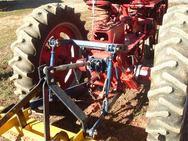

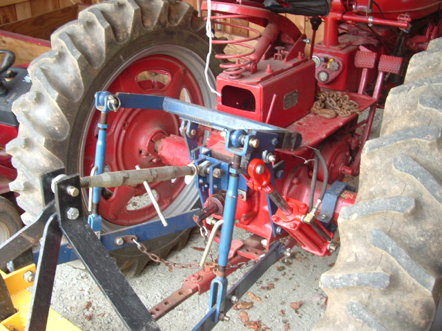

Can anyone point me to some plans to build a 3 point hitch for my farmall H and M? I've never seen one up close on one of these and just don't know where to start.

I can't help much with the H, but here is how I built the one on my C farmall. Also Agri-Supply has the lift arms on sale now for 20.95. That is cheaper than it cost me to make my lift arms.
I hope these pisc help some, later, Nat

Nat- Good pics, that helps me out alot.
Kwolfe-I've seen them on ebay. They are so high oriced though. I'm hoping to save that as a last resort. I think I can go to the tractor store and get the links and stuff for the price of the shipping they want.
Scott_vt-Thanks, thats a great drawing, and also helps me alot. I think I'll go forward with collecting parts and pieces to build my own.
