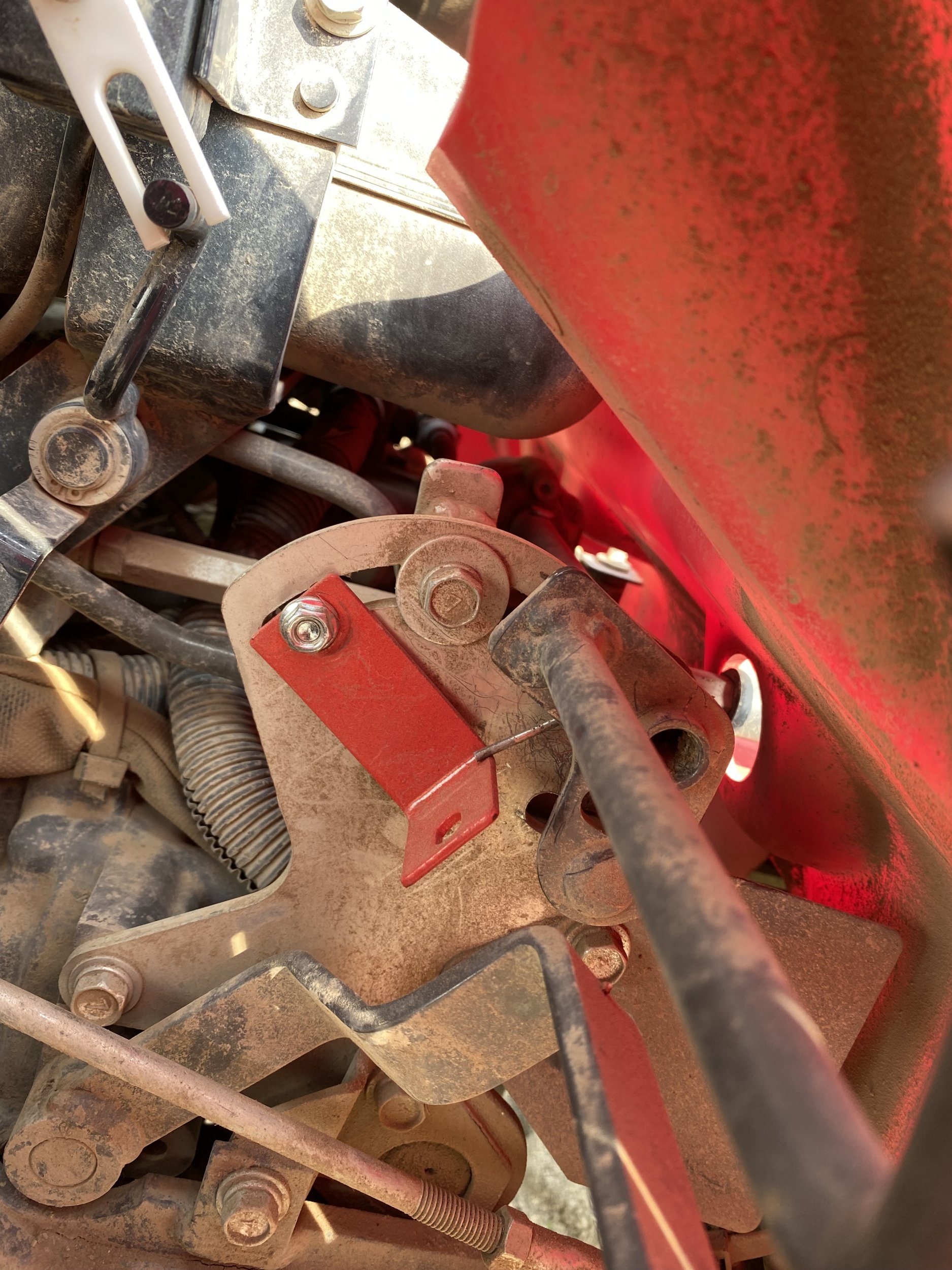

High guys my 2018 Massey gc 1710 has an issue where the 3 point won’t stay down. I initially thought it was because in the winter when using a scraper blade it was to light and the snow would push the blade up, but I’ve now got a tiller that weighs almost 600 lbs and it’s doing the same thing. I have to constantly hold down the 3 point lever in the down position or the tiller will raise up. It’s getting frustrating, is there an adjustment that I’m missing? Thanks all.

Thanks for the response, Hmm, ok so when I use the tiller I lower it down to ground and start moving forward, then it will on its own raise up a few inches, so I push the lever down again, if it gets raised up from going over a hump or pushed up by hard dirt , it won’t go back down, and will stay raised, so I’m either having to keep an eye on it all the time to make sure its down or drive with one hand holding the lever down, neither of which is a comfortable situation.

You maybe right, but I can lower the implement all the way over an edge where it’s hanging in the air before moving forward to engage the ground so I know it’s fully lowered. But as soon as it engages it has to be lowered again, it maybe designed that way. but if it is it would be annoying for anyone with a 3 point mower deck going over bumpy terrain. I will try adjusting the rate of drop knob and see if that makes a difference. i would think there is some kind of float that keeps it down but there’s no indication on the lift and lower lever.

There is no float, and it is not designed to go back up. Once lowered to a specific point it should continue to return to the point. When the ground pushes it up it only pushes on the lower arms. This can be tested with your implement off. If you lower the 3PT all the way you can manually lift the arms about 1 foot and then they will drop down to the same position. I don't know what would happen if the ground pushed it up past that 1 foot of play. Are you tilling over hills that are more than 1 foot high?
   / 3 point rising up
The lower arms do float but when it’s hooked up to the hitch it’s all connected to the hydraulic raising arms that raise and lower it meaning everything gets pushed up. Maybe I’m hooking it up wrong? Any way for the time being I’ve installed and L bracket that holds up the lever spring that makes the lever return to middle position, it only affects the lowering not the raising, so now the lever stays down when lowered. So now it “floats”.

Ya it’s gravity down, just seems odd that a 591lb implement won’t stay down by gravity, it’s good now that I modified the spring on the lever. I still think it’s supposed to stay down by itself without having to hold the lever down all the time.
