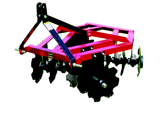

Have you considered a disk harrow instead of a tiller for the plots? I have a 4' Howse disk for my BX and me and every one that was seen how well it fits and performs has been very impressed. The disk has a lower setting in the farm height that is perfect on the BX. It weights 423# and with the FEL on handleing and tractor is no problem. You can disk at full speed in low range and 2 passes with the disk on even hard packed ground levels the ground ready for planting. I prepared about 8 acres of plots with mine in a day. Another good thing about the harrow is if u run over hidden stumps over rocks it will just roll over them with no damage, would not be so lucky with a tiller. Always wanted to try the clovers but have always stuck with the annuals and grasses. Besides if the clover worked as claimed what would I do twice a year during plot prep time??!! Heres a link to howse and attached is a pic of the disk. [http://www.howseemplement.com]

I've got a 54" Howse tiller and it is as good as any tiller I have seen. Up to 7" deep, tines rotate in either forward or reverse directions. ~720 lbs. Even so, I do have to agree with you on your disk harrow analysis, though. After all why don't more farmers use tillers?
