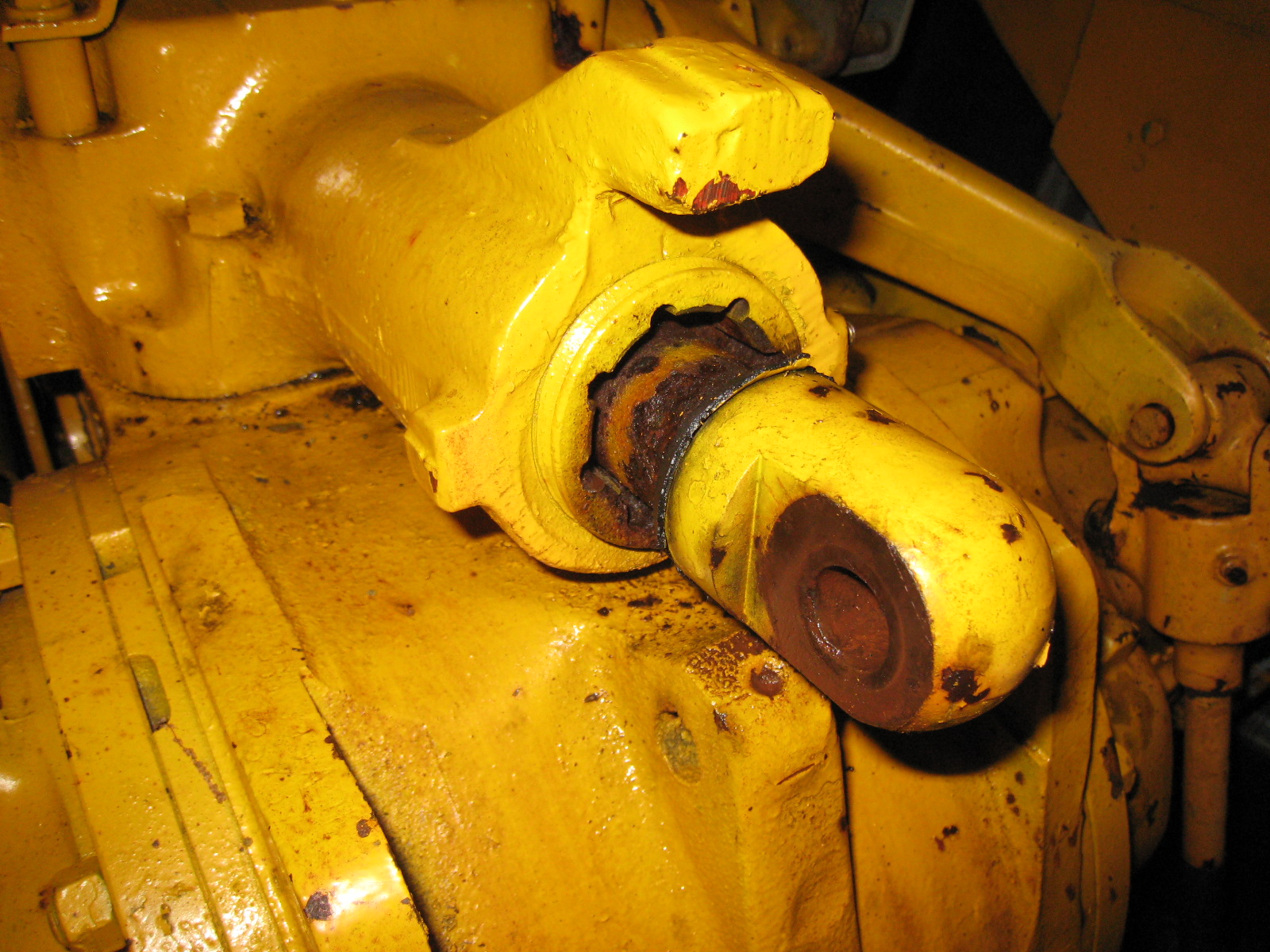

Anyone know if a spanner is available for the nut that holds the top link plunger and spring in? I saw one post that advised to take out the set screw (which I did) and use a punch to work it around. Hate to say it, but this one is going to take more than a punch to break it loose!

The upper link adjustment nut on your tractor looks very similar to the one on my MF 302. For the 302, the spanner wrench needs to be 2 inches, center to center, with 1/4 inch diameter pins. Before you buy a 2 inch spanner, measure your tractor nut with a ruler to verify that yours is in fact 2 inches also.
To loosen the nut, I suggest the following: scrape away the yellow paint, and get some solvent (Kroil) on the threads.
The location of this nut is critical for the operation of the 3 point hitch. Note its current location (count the threads showing) before you disturb it.
I just bought a 2 inch spanner wrench - with 1/4 inch pins - on eBay. Here's the link to the seller:
NIP JH WILLIAMS 2" SPANNER WRENCH# 426 USA | eBay
Good luck!
-Don
