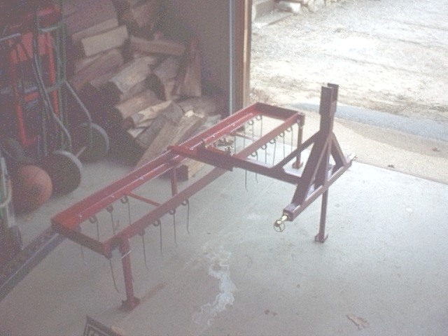

I just built one for another TBNer. This one was 68" wide and 12" deep with 16 double tines (2 rows of 8, offset). It has a detatchable 3pt hitch with 4 total parking stands, pretty neat. It took me 2 weeks of working a couple of hours each night. I have pics but they are on my sons camera. It cost me about $200 in steel and other materials, not counting the tines which MikeD got from Agrifab.
   / 3 pt Dethatcher??? #4
Ok, I got his camera and here is the picture. Note that all of the tines have not yet been installed

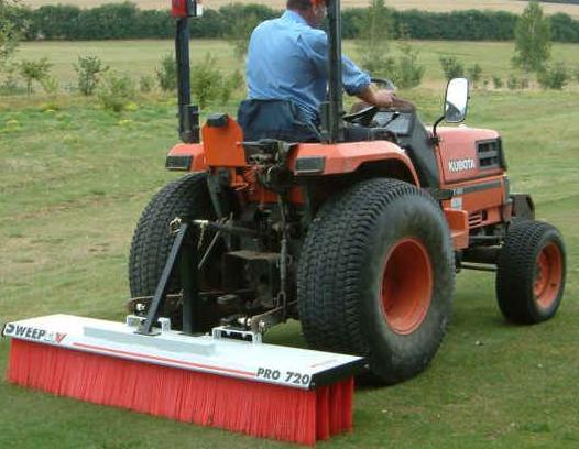

Here is another option.
