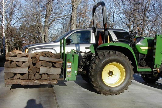

What can anyone tell me about different brands and types of rear mounted fork lifts. /forums/images/graemlins/confused.gif Inexpensive would be good, but sturdy as well. I will, initially, be using it to haul pallet sized loads of firewood.

I re-worked my FEL pallet forks last year to attach to the iMatch on the 3pt. I use it back there, when I have the snowplow on the front, to bring firewood in on pallets after air drying for two years. It works great, even when I have the tire chains on which make it a bit bouncy.
A pic around here somewhere, and will look for it.

These were pretty cheap. Just some 1.5" x 1.5" x 1/8" tube and 3/4" bolts for lift pins. The brand is Quick N Dirty /forums/images/graemlins/wink.gif
I'm too lazy to stack wood on pallets ... I just throw it into fruit bins. I can lift a full box of fir/pine/cedar with my loader forks but had to cobble 3ph forks for the oak cuz the loader wouldn't lift it.

I am 'impressed' and actually amazed that the welds at the corners of those 'forks' hold up that load. Truly impressed. /forums/images/graemlins/shocked.gif But happy that they do. /forums/images/graemlins/wink.gif
