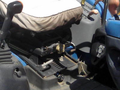

I have to stand on the arms of my TC40D's 3Pt. Hitch to get it to go down any faster than creeping. It raises fine. What could be wong? It used to raise and lower at the same brisk speed.

Turn the little drop rate knob under your seat counterclockwise. This knob regulates the rate of drop of the 3pt hitch, and needs adjustment depending on the weight of the implement on the 3pt.

Thank's James. I suspected it was something simple. I monkeyed with that knob to try to get the seat stiffer. It was bouncing/bottoming out bad and I thought the manual referred to that knob for adjusment. Oh well, guess I'll go undo my "repair"!

As James said, the drop rate knob below your seat is directly below the bigger knob that adjusts the seat height/tension. It's the little black knob with white writing in this photo. It only functions to set the drop rate of the 3PH. Lifting the 3PH bypasses this needle valve. Also, with nothing on the lift arms, they will be slower going down than raising in normal operation, but they should fall at a pretty good rate if you have the drop rate adjusted properly.

Well check your manual carefully, I have a seat adjuster under the seat too, and the 3pt drop knob.. Of course my tractor is a kioti not a NH, but they are all similar. If you turn the drop rate knob too far clockwise, the 3pt will not drop at all, no matter what is on the 3pt. Good luck with it..
