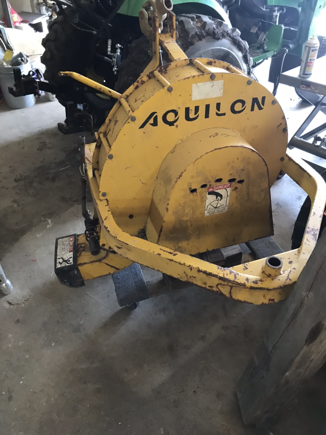

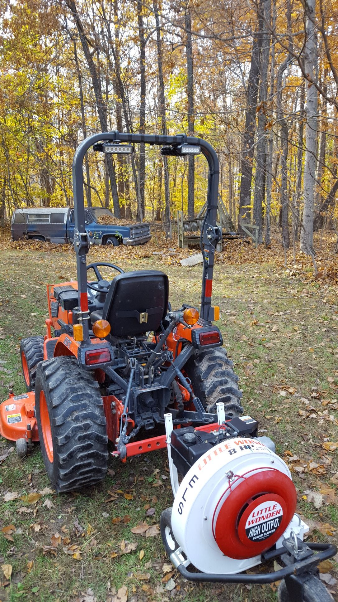

The cheapest and most effective solution I have come up with so far, is to pull a 8hp gas Little Wonder push leaf blower behind my tractor on the 3pt. The good thing is, it blows the same direction as the mower deck. I run the mower deck at the same time so I can get up close to things and the mower deck blows it out a little then the leaf blower will send it 15-20 feet depending on conditions.
I found an old used 8hp Little wonder push leaf blower in excellent condition for $500. Went to my local Tractor Supply and got a 3pth draw bar and some U-bolts. You want a leaf blower with a front swivel wheel. One of the things I do alot when bloweing leaves is backing up so I am always blowing in one direction.
I had an old used Trac-Vac pull behind leaf vac. It worked good, but for my property it was a lot of trips to dump it and would get clogged with sticks quite often. I even ordered a new one at one point for something like $3700 (like 7 years ago) and I couldn't stomach the cost and cancelled it the next day. I have the benefit of being able to just blow my leaves into the woods so I don't really need to collect them. So my first attempt at using a push leaf blower was a $350 5hp Coleman Cyclone from HomeDepot. It worked good, but was just a little too small and flimsy to be behind my tractor. It had a very small front swivel wheel and would bend easily if it pushed into a tree root or similar obstacle, but I still used it for a couple of years until I got the bigger Little Wonder.
I went form taking a day or two with the Trac-Vac, to 6-8 hrs with the Coleman, and now 2-3 hrs with the Little Wonder.
You just have to remember to be very careful when backing up. The tractor doesn't even know it's back there and will bend/mash it up easily before you know it. I intend to make a more rigid frame/dolly for it, just haven't got around to it yet.
