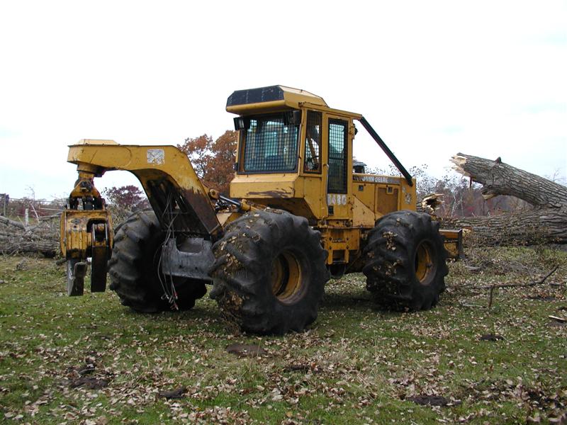

Looks like a good idea, except I don't see a swivel in the design. It's gotta have a swivel, or going around corners with the log will make the tractor steer hard or the log to get all gouged back and forth at the grip area. Actually, it needs to swivel fore and aft and side to side too, or similar gouging will happen. Basically, the grapple part should hang from a swivel fitting like found on chain hoists (or maybe it is just a few links of chain). Seems like I saw this on a full-size skidder. Here is a pic... when I saw this thing working, the grapple was swinging all over the place. I want to build one of these anyway, maybe I shoud give it some more serious thought. Will let you know what I come up with.

Seems more complicated than it needs to be. We moved telephone poles with simple tongs on our pole truck. Why not make a basic pair of tongs on a swivel? I realize the primary drawback is that it would require getting off the tractor or using two people, but that thing looks super expensive.
