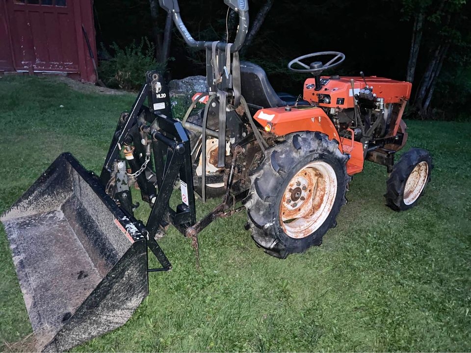

I know this is old, but it's a good topic. Here is one that raises with a hyd piston above what the 3pt lifts.

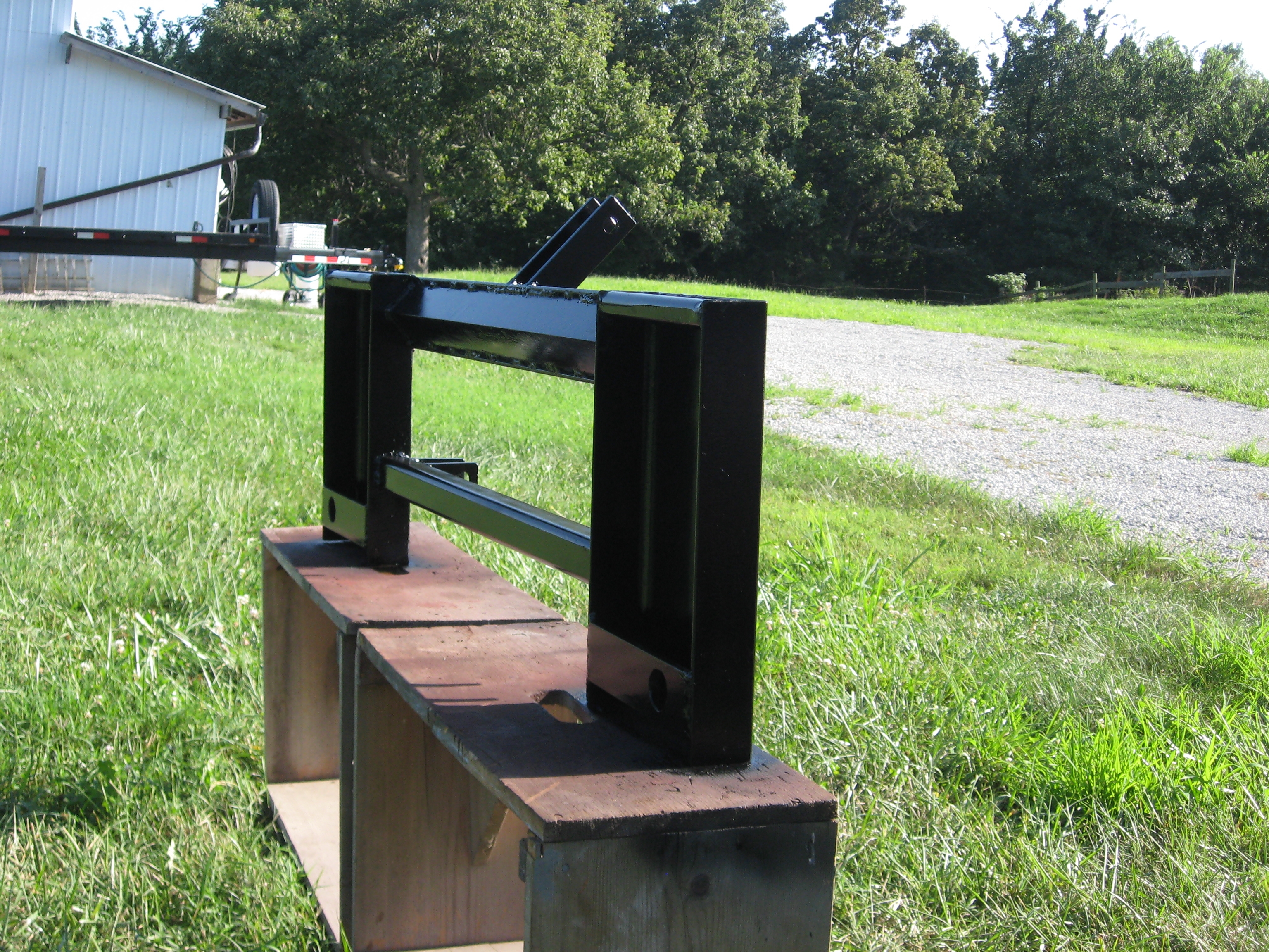

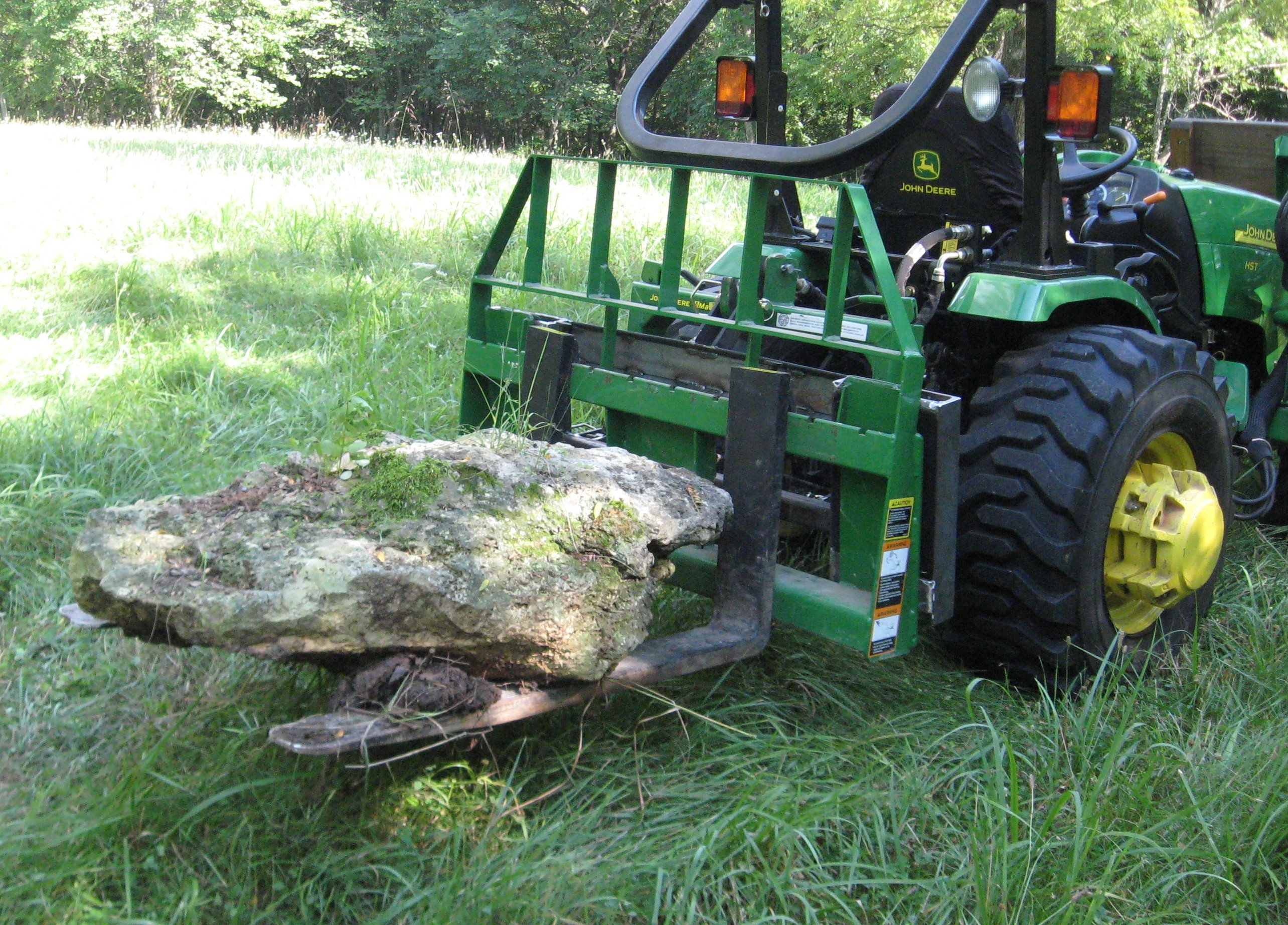

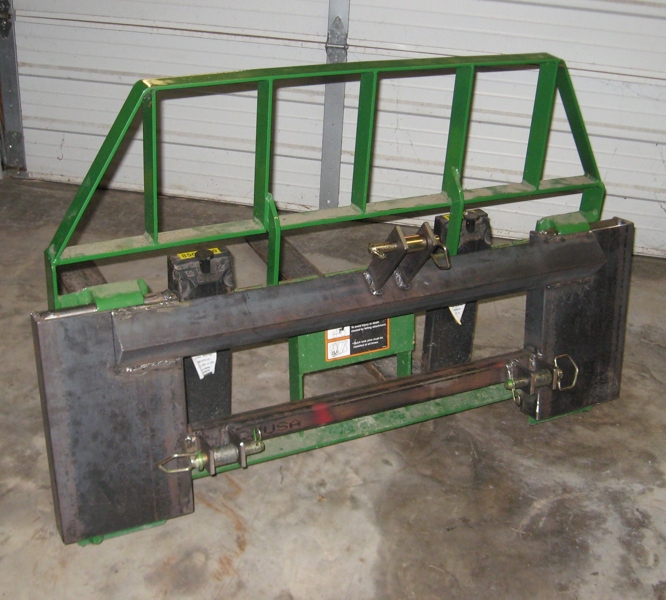

I made up this three-point adapter for JD hook and pin connected stuff (bucket, pallet forks). Main idea was to carry things too heavy for the loader on the back. It works, but doesn't go very high or dump, and not many things I need to lift that are that heavy. It is also heavy as all get out. Now that I have a tote to water trees with, I might start using it for that because I can't comfortably carry that thing more than about 1/3 full.

It makes a lot of sense placing the heavy load over the larger rear tires.
This "loader" actually has a hyd piston that lifts it higher then the 3p could ever lift it.

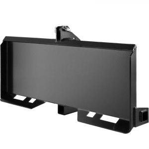

I use this 3pt to SSQA adapter to put a FEL bucket on the 3pt:
I then use the hyd. top link cylinder to pick up and dump heavy material.
It's tough to get a full bucket and the lift is limited to the 3pt height but it works for moving material around. With a bucket on the FEL and another on the 3pt, you can move twice the material in a single trip.
It also works well for rear ballast.
