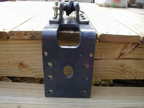

Yes I think you may have pulled the piston out of the cylinder, if you lifted the arms too far. With that broken part gone there would be no stop to prevent the over travel and it could be out.
When you get it back together you might check with your Kubota dealer for the HD kit. It should be available for any of the L tractors. Here is a picture someone else had posted in the past. KennyV.

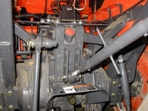

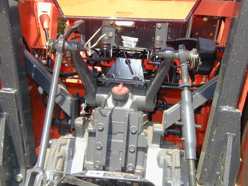

OOPS I didn稚 get the one after he had it attached
This is it. Your痴 will be similar. KennyV.

I went a different route on the new top link attachment. I attached some 3x3x1/4 square tube to the ROPS at the same height that the original top link should attach. I will have to get a shorter top link to make it work ,but I was not aware of the heavy duty bracket, and I did not trust the cast anymore.
I will try to have some pictures posted of the new setup.
