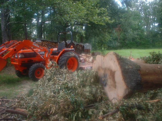

If you attach a log splitter it will tie up your tractor.Even without a FEL you can drag the logs to the splitter before cutting.
