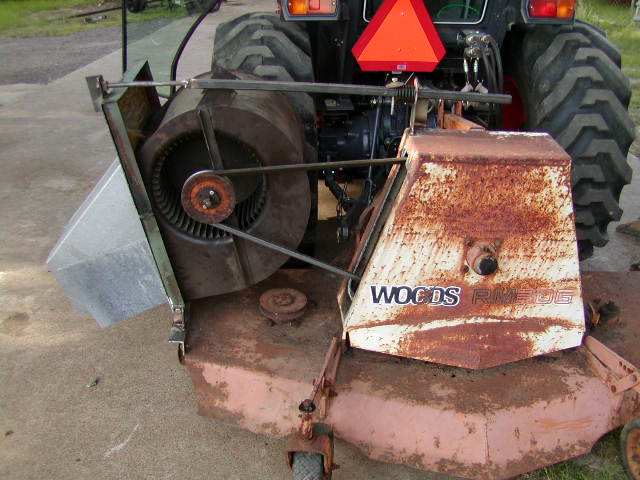

I built my own (Tim Taylor driveway blower) using an old discarded woods belt drive finish mower & an old blower out of a furnace. It is 3 point mount. Since I took these pictures, I have removed more of the rear portion of the deck & the wheel & just carry it with the lift. I think I can run the blower about 3 times the speed it was designed for in the furnace. Works Great, cost a little of my time.

Blows this 2x4 stud off the drive from 8' away at about 1/2 throttle.

Neal,
Great idea. I have a extra blower, but I will try to get a larger one. A blower like that could save me some real time.
