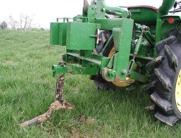

Hey guys,
Does anyone make a 3 point pipe puller for installing underground irrigation pipe, cable, etc. Any help will be much appreciated. Thanks John.
   / 3 pt pipe puller?? #2
John, there have been a couple of threads on the subject. Most use a subsoiler attachment and fabricate either a "mole" to pull behind it (entire length of pipe/cable is moving through the soil) or a J-tube on the back side where the pipe/cable is fed through (cable doesn't move in the soil).
Here's one recent thread <A target="_blank" HREF=http://www.tractorbynet.com/cgi-bin/compact/showflat.pl?Cat=&Board=projects&Number=154808&page=&view=&sb=&o=&vc=1>Under ground cable</A> /w3tcompact/icons/smile.gif

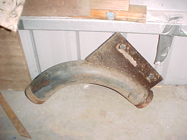

Johhny
Further to the post shown below........
Attached is a photo of mine.
Slighter stronger and larger than the conduit version. Mine can do up to 40mm pipe (Have only tried 25mm to date but aim to do some 32mm tomorrow)
Works fine as long as the ground is soft. Ground here is like rock, but having just had some rain I aim to get into some tomorrow.
