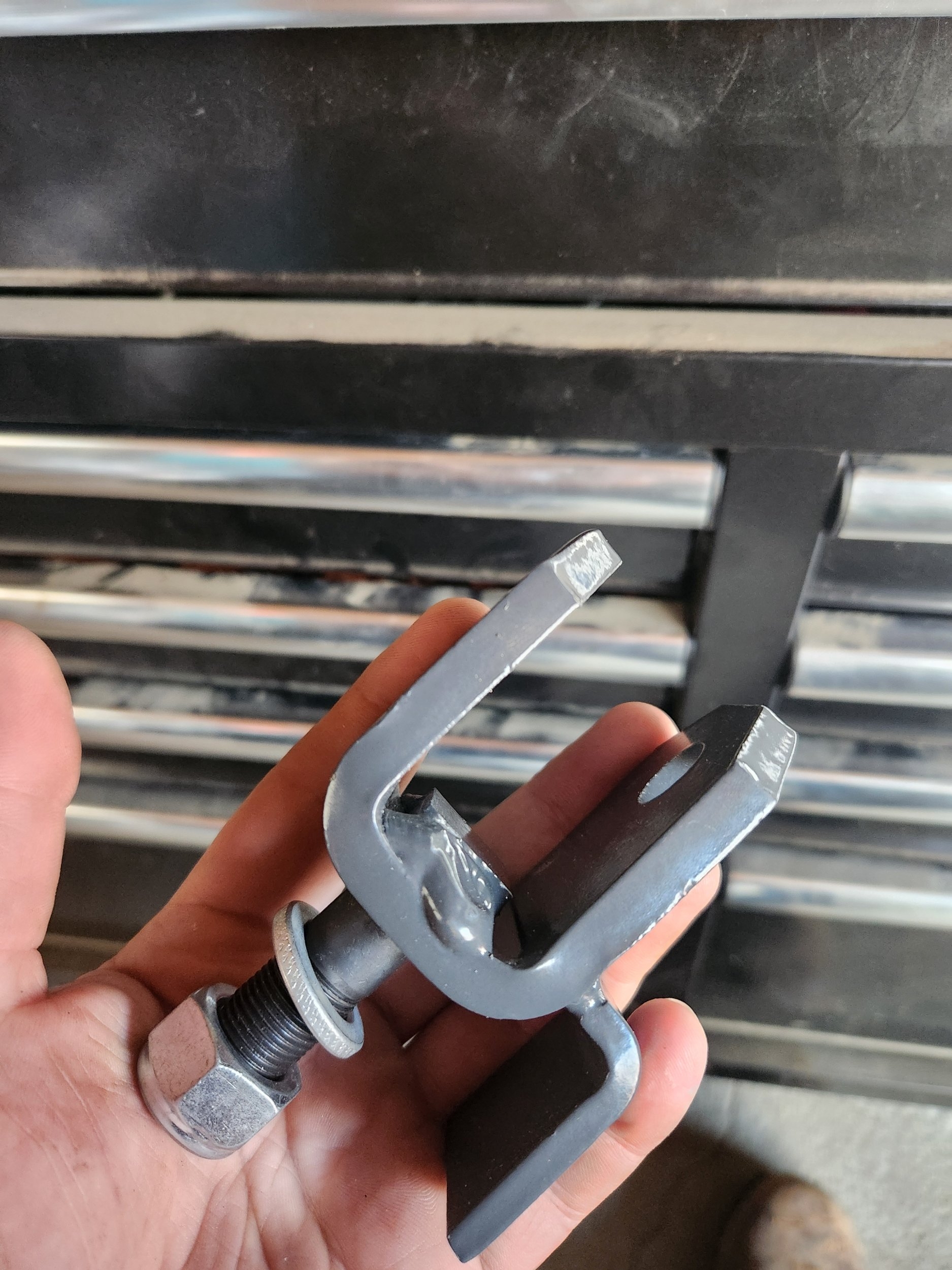

Hey everyone. Wondering if anyone has changed out turn buckle stabilizers for telescopic kind? If so any details would be appreciated thanks

Get a Quick Hitch and keep your turnbuckles. You will never get the telescopic arms to align where you want them. The holes rarely align where you need them, so they'll be too loose, too tight or the arms offset to one side (hard on equipment).
A quick hitch will make you convert all your implements to a single Category. Don't ask how I know. But it's worth the effort if you have more than one implement. It might also make you buy a hydraulic top link to save even more time.

I sure did. I hate turnbuckles; I have replaced all of them over time.
Telescopic stabilizers for the CK need to be welded on, so I found some Kubota parts that allowed me to rig it up.
