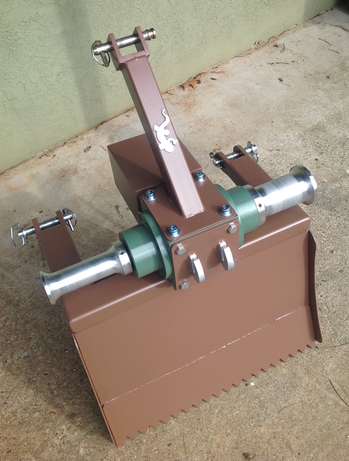

   / 3 pt Winch #13
I looked long and hard at that Norwood winch. Best I could tell they didn't seem to be for sale anymore. I then spent a long time doing the math on a hydraulic capstan winch, and it didn't pencil out well.
On my small tractor, with only 4 GPM of flow, I could only get about 5 HP out of the hydraulics. The total pulling power then was something like 1500lbs. Crummy little electric winch could beat that.
So in the end I went with the same idea as the original post here, use the PTO, through a gearbox. I have 20HP out the PTO, then through a 4:1 gearbox. I forget the exact numbers, but netted something like 4000lbs of pull. Still not a insane amount of power, but good enough to get real work done.
If there is enough demand, I can probably do a longer post about it.

   / 3 pt Winch #15
Indeed there is interest here as well. Lovely and well thought out - you can pull from either side as well. I have (claimed to have anyway) 31 hp at the PTO so there should be a lot of grunt. We need to know sourcing and cost especially - but I'm dying to see your fabrication as well - very nice looking unit. Also, how does she pull with your little tractor compared to the video of the Skid Winch? Thanks.

   / 3 pt Winch #20
Alright, did a full write up here: http://www.tractorbynet.com/forums/build-yourself/392375-pto-capstan-winch-scratch.html
flingwing1969 - I consider the Norwood Skid Winch video to be...how shall we say, less than impressive. Skidding over clear, leaf-covered ground, is as easy as it gets. The videos of Farmi winches are typically much more interesting, stuff like pulling three trees at once through nasty terrain.
Originally I set out to just build my own clone of the Norwood, it looks so simple, anybody could build that. But hours of shopping for hydraulic motors came out with nothing that made sense.
High speed, low-torque hydraulic motors are readily available, but useless in terms of pulling power.
Slow speed high-torque motors are also plentiful, but all require massive flow rates, like 15-20 GPM. On the hobby-end of the tractor market, nobody has tractors flowing that.
I have no idea what Norwood picked for their unit, but given the video, I suspect they had to make a compromise in the end, and the unit lacks pulling power. Pretty sure my PTO winch easily out pulls it.
PILOON - If I didn't have a dual-shaft gearbox, I would have done vertical mounted drum. Working out the mounting for this gearbox in a vertical configuration was hurting my head too much to attempt, so I just went with horizontal.
