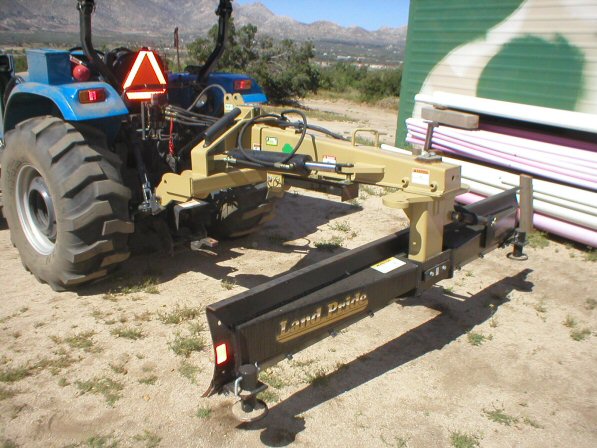

Take a look at Land Pride RBT35 Series Rear Blades. Very good quality, if you have rear remotes, a hydraulic controlled unit would be nice. But if you need to save some $$$, then the Land Pride RB35 Series Rear Blades may be the way to go. I would get an 84" wide blade myself. In fact I have been thinking of getting one of these for my Mahindra 3215. I have its' big brother, an RBT45108 for my 7520 Mahindra, very nice implement.;)
Oh, if you don't have your tires loaded yet, you should get them filled, it makes a world of difference.
