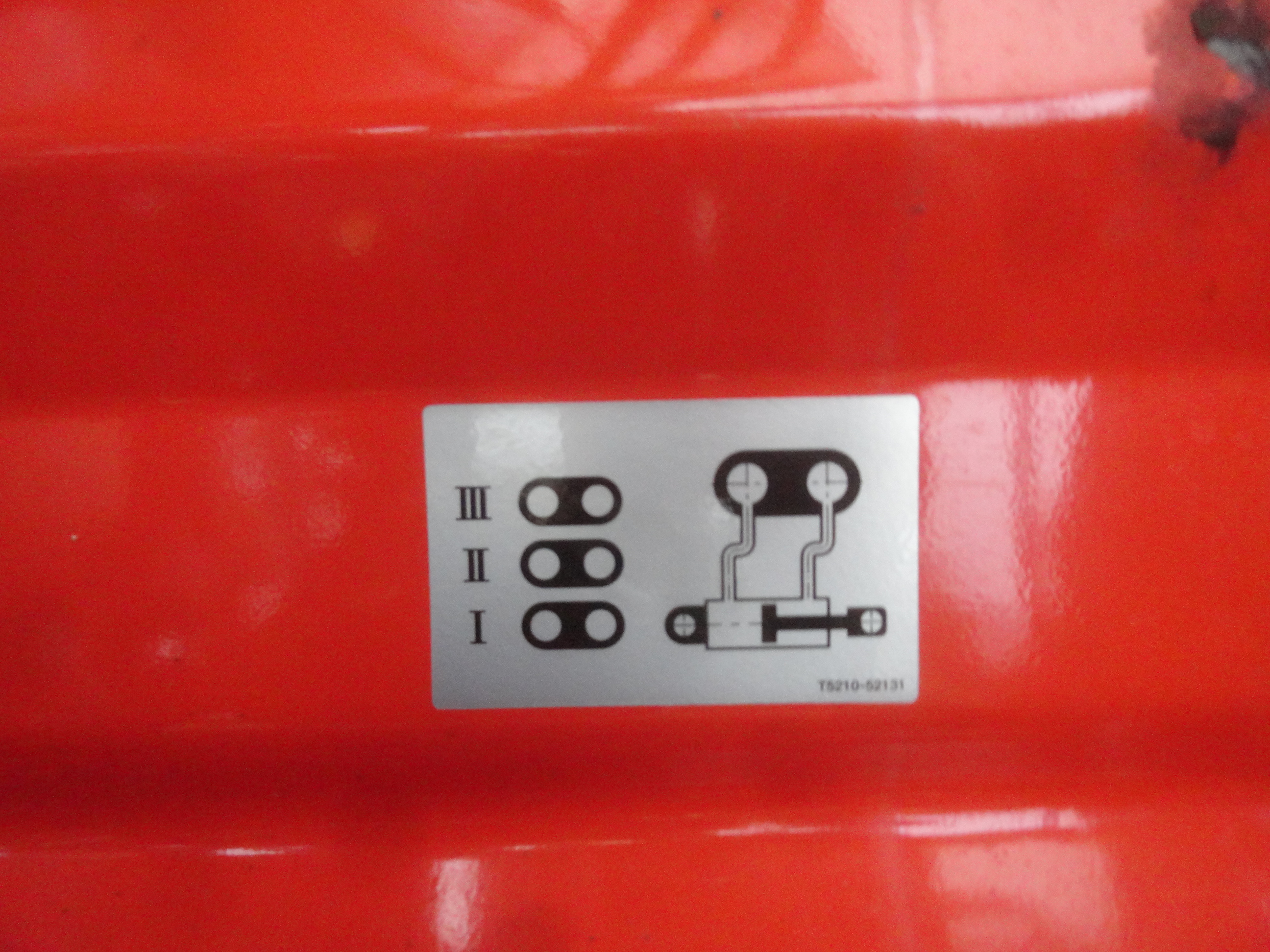

I read quite a few posts about installing 3 remotes on the rear of Kioti tractors, although Kioti says no. I looked on the back of my NX4510HST today to see what if anything was there for info. Sure enough there is a picture of 3 sets of remotes on a sticker on the underside of the body.

Jim, that decal is a hoot! How new is your tractor, and could you describe more specifically where on the underside it's located?
Curious, was it a dealer that said they couldn't install a third rear remote, or did you hear that from Kioti corporate? If the latter, wow, they need to update customer service. Although there technically isn't a "third rear remote kit" offered in the U.S., all that's needed is an additional No. 2 valve body kit, and two longer bolts because of the added thickness: 10-1.25 x 170mm, ideally grade 8.8 or better. Fastenal has them. BTW, my dealer in Mineral, VA did this for me last July when my three-year-old NX was in to have an ECU programming update and a couple of other things.
If Kioti corporate in Wendell is still not recommending using the No. 2 kit as a third remote, maybe it's because the lever will be color-coded (blue) the same as the existing No. 2 lever, rather than green. That's a non-issue, as a practical matter. There is already plenty of room on the stack for a third valve body, as well as a cutout for the cable and a slot for the third lever already in the control console.

Threepoint, My NX4510 is a 2015. The decal is directly above where my single remote is located. Funny thing is I never saw this decal until yesterday when I was tucking some light wires up under the back of the rear apron. The dealer did not mention this to me. I saw this on TBN in several posts. On this issue of the 3rd valve. I only have one more available slot for a lever. What do you do about the 3rd lever, double the handles up? I believe that the cab version have 3 slots.

Aha, I didn't realize that the lever slots for the rear remotes are different on an open station. If there's no apparent place for a third lever, that makes the decal even more surprising to me. Maybe another open station NX owner will jump in with an answer or a work-around.

Yup, the confusion lies with the difference between cab and non-cab. I was down this same path. I wanted three sets and it turned out you cannot get three on a non-cab- has to do with with the controls: in a cab there's room for three. When I discovered this I put a stop on my order and, with input from several people here, switched to a cab: this issue was just one more thing tilting me toward a cab.
You might be able to get them to install the valve bodies and the second lever and cable, leaving you to figure out how to add on another lever (they might provide it with their kit, in which case you would hope to be able to get it to work for you so you don't have to buy something else).
I would have been able to live with just two remotes. And if push came to shove I would have gone with a diverter valve up front: that would leave me with a spare rear remote; as it is now I'm using one rear remote for a third function (other is for my top link).
