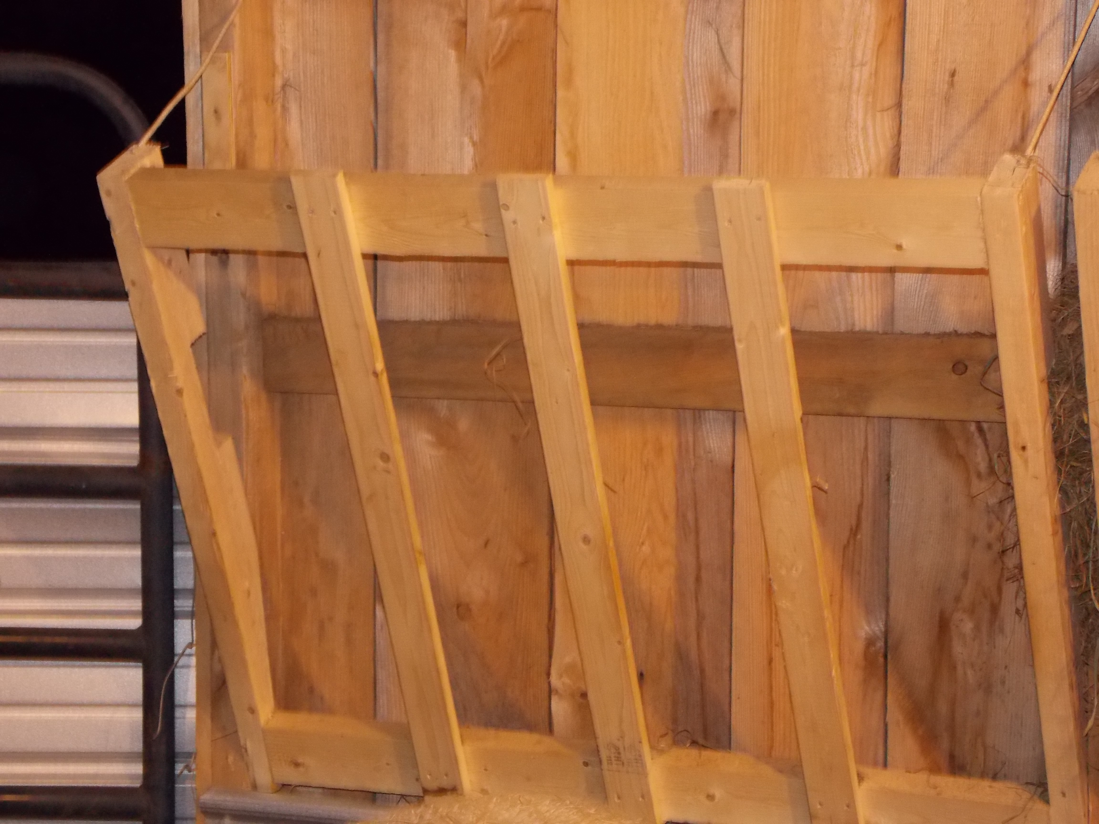

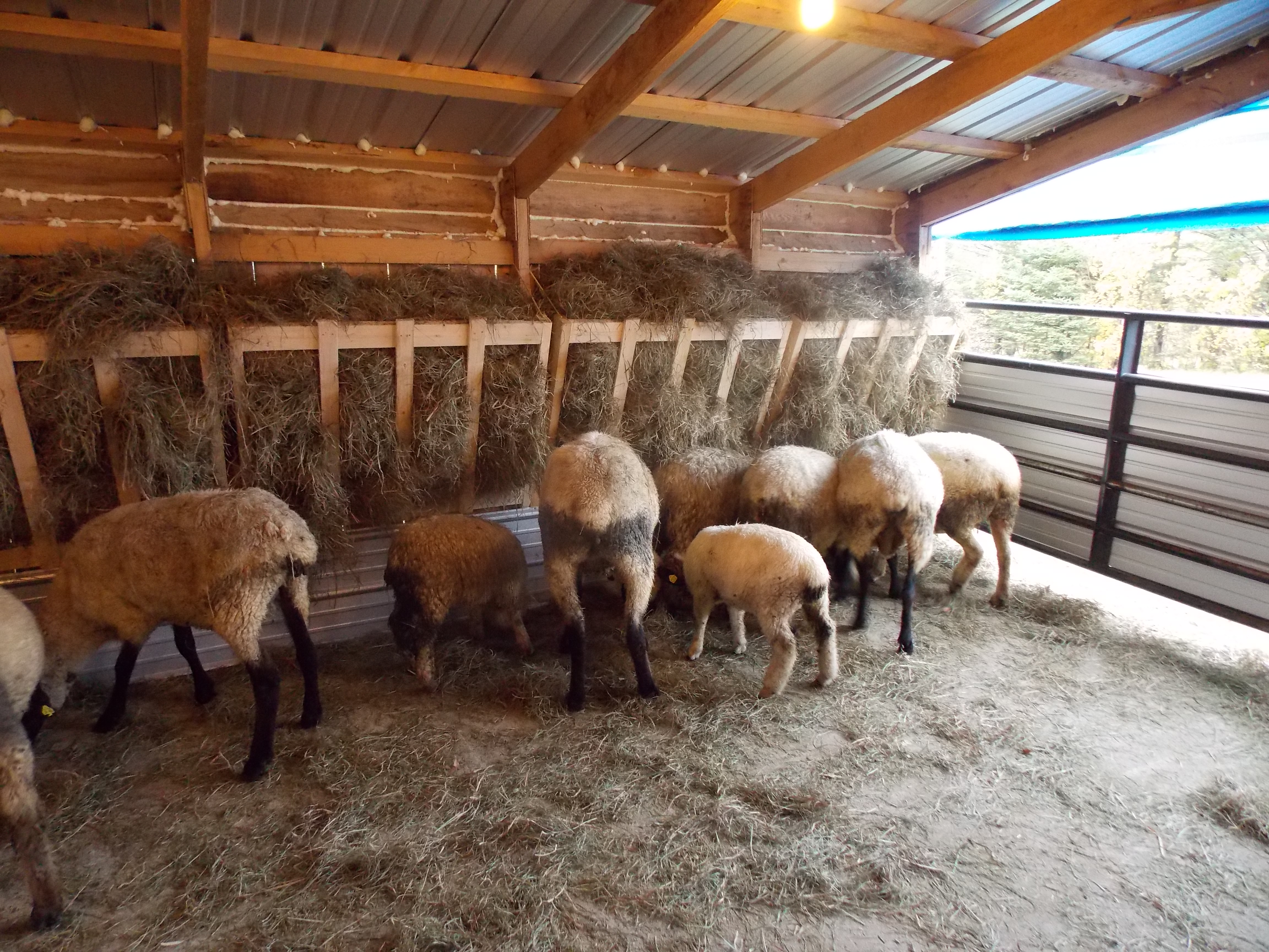

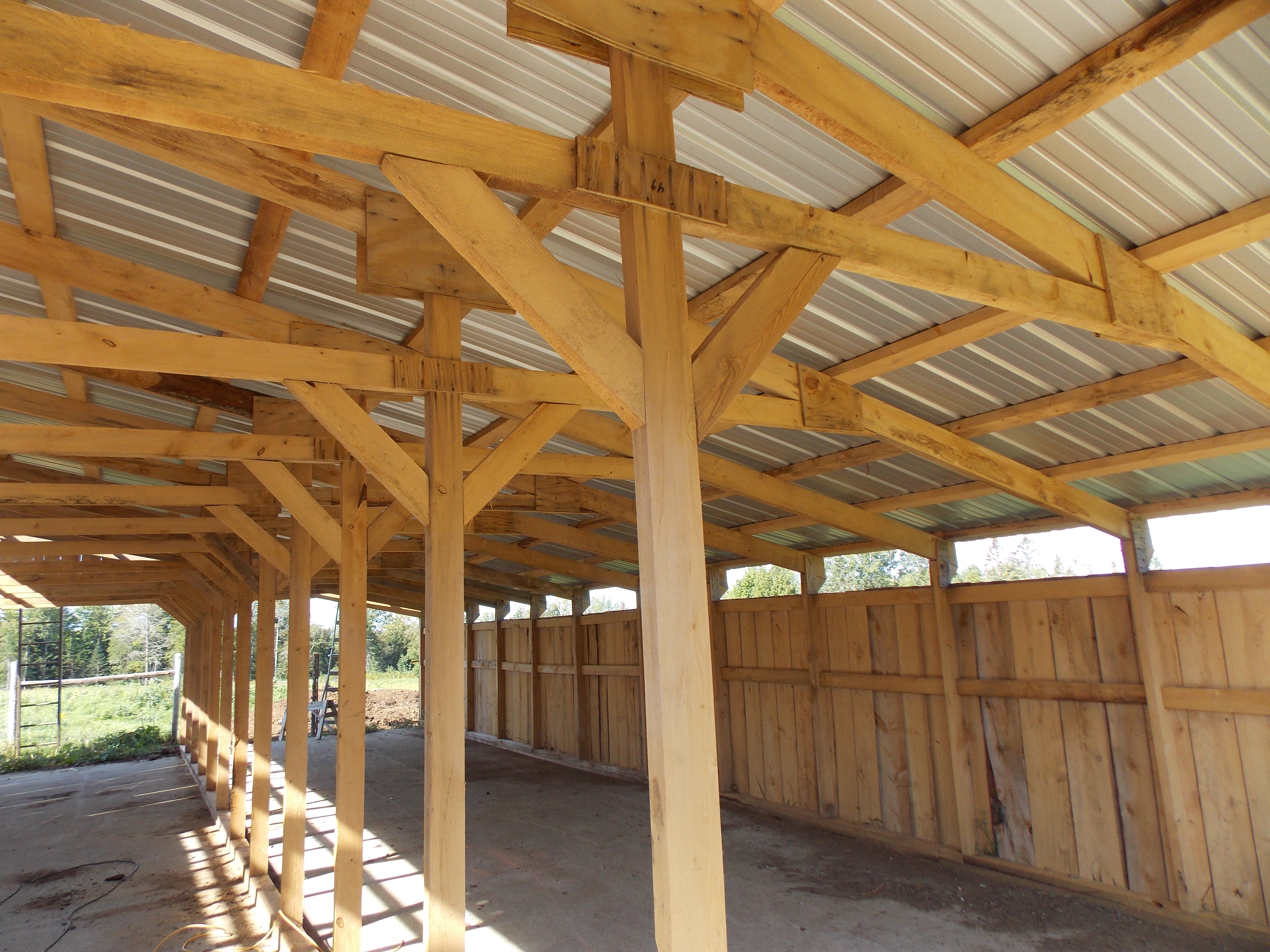

I built what you are looking for back in 2015. Mine was 30 x 48 and I built it for $4450, although I did already have the concrete pad.
Most of the money was in buying the new steel for the roof, but I saved a lot of money by sawing my own logs into lumber. Still, I built it chicken-barn fashion in that it was framed four feet on center, then purlings for the roof, and board and batten siding.
The overall design was it was a through-barn, so using pipe-gate ends, then using self-tapping screws to attach steel roofing I was able to get the ideal mix of being draft-free for the sheep and lambs down below four feet, but a lot of ventilation above. In the first year I went from a 11% mortality rate on the lambs, to less than 1%. It really was amazing the difference a barn made.
Mine was primarily for sheep, but it amounts to a (7) car garage, so I have stored a SUV, a bulldozer and a tractor inside while riding a blizzard out on one side, and the sheep on the other. We split the main barn in two for support, but it allowed us to have the sheep on one side when we cleaned out, and then put them back on that side, as we cleaned out the other. Fold-up hay racks worked well too because hay racks save a lot of hay with sheep. They also self-shut them as they pushed against them for those last strands of hay. This allowed them to be out of the way of my tractor when cleaning out. And that was where lining the insides of the barn with steel roofing helped. It kept the manure from sticking, so I could push out a pile of manure all at once.
In the half-wall that separates the two main bays, we put in gates to cross from one side to the next. Then with pipe gates in the center, it allowed us to have (4) pens for the sheep, so we could move the sheep from pen to pen without chasing them. It really worked well. In fact, normally we build something, and then in a few years refine the design, but this barn worked so well that we would not change a thing.
In the smaller area of the barn (12 x 24) was our lambing pens. This was insulated, with 4 x 6 pens for the newborn lamb and eye to get acquainted. With a few sheep in that area, with the insulation and their body heat, it never got below freezing. In the alley way leading from the main barn to the lambing barn, I put in an in-floor foot bath. The other area of the barn (7 x 24) we made into four foot pens, and had this as our "Medical pens" which was for any sick sheep that needed to be separated. This could also be a place for chickens, pigs, or cows though too.
