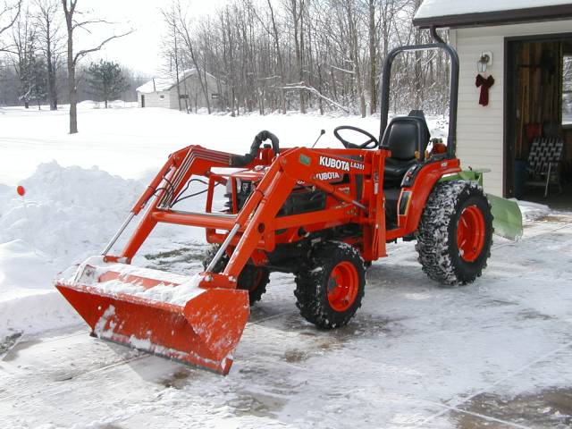

I don't know how steep the slopes are or how loose the ground is where you are. I just got a 7 foot Land Pride rear blade for my L3000DT and using it to move snow didn't cause the tractor to break traction at all.
The rear tires are loaded on the tractor so that helps a little. This past fall I groomed a friends driveway, which I consider really steep, with my York rake. The Kubota didn't hesitate even with a good load of gravel pulling up hill.
I am really impressed with it's performance.
Randy

u should have no problem at all, i use a 6ft blade behind a smalller tractor and i seldom have a problem. keep us posted and send pics.
