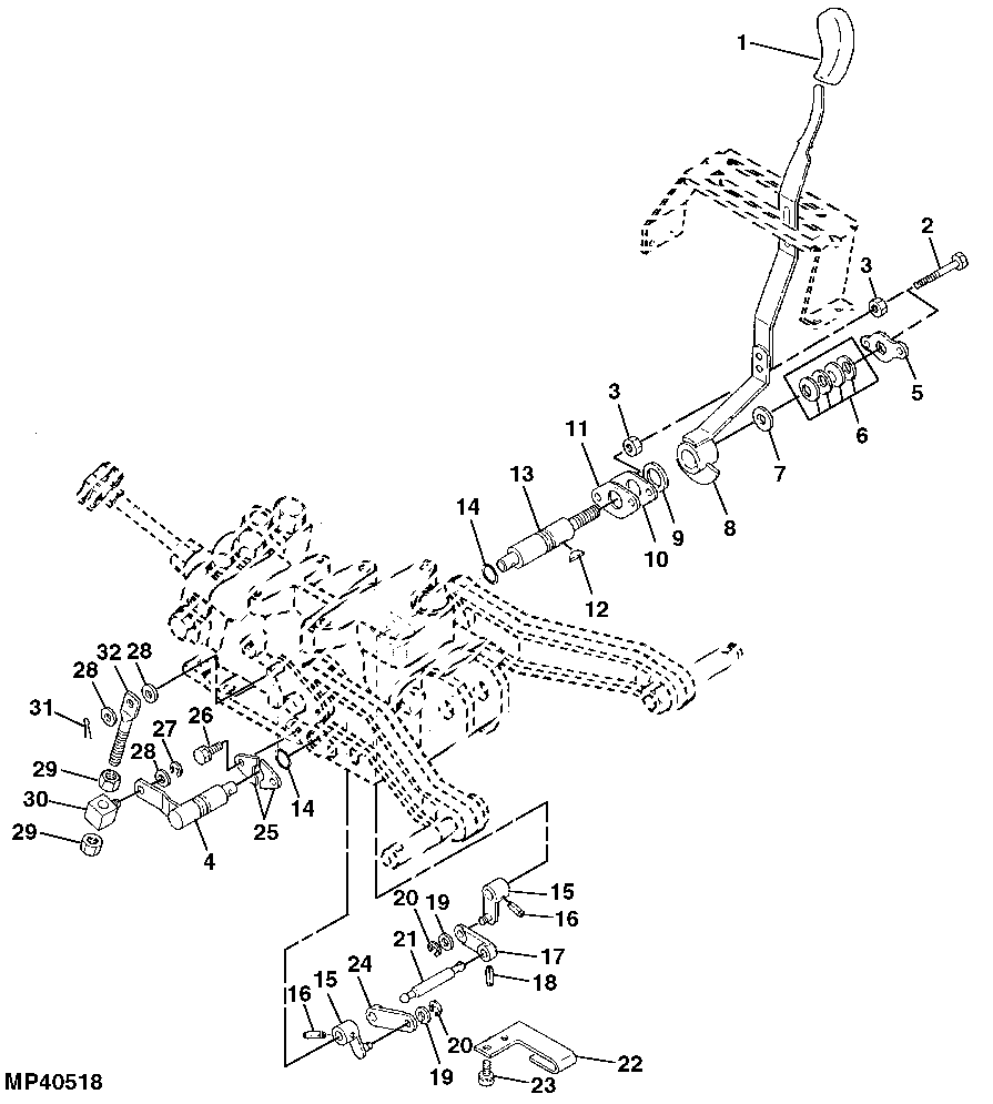

The lift control lever on my 3005 is kind of hard to move when raising or lowering the 3pt arms. Is there an adjustment to lessen the friction? I looked up the parts diagram on deere website, but the parts list didn't give any indication of a friction disc or washer on the assembly. The owners manual has no information on it either. It doesn't bother me when I'm using the finishing mower, but when using a cultivator or harrow it is frustrating. Oh, and I really hate the sway chain turnbuckles they put on that tractor. That is the only negative thing I have found with it. It turned 5 years old this week and I forgot to throw it a party.:laughing:

I can't look in JDP right now, but there is usually a set of friction washers that can be adjusted with one bolt or nut. Have you tried lubricating the linkages? Fluid Film is great for that.

Adjusting bolt #2 should adjust the tension.

Thanks for the replies, I will try adjusting the bolt in the diagram.
   / 3005 rockshaft control lever
After a closer look at the diagram, item#6 looks like a friction washer assembly.
Bolts #2 and nuts #3 are the adjustments. I backed off 2 flats on bolt #2 after loosening locknuts #3 and every thing was good. Two 12MM wrenches and small hands are needed.
