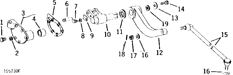

Can anyone tell me why my 1972 JD 300b industrial has such loose steering. The front end seems tight. Does it have an adjustment in a steering box somewhere or is the steering box history? Thanks.

Have you checked the bushings or brgs in part(bellcrank) under the very center of frrt axle for excessive wear? Remove rear inspection plug in clutch housing and be sure that the bolt(parts key 14) you'll see is TIGHT. Are tie rod end on draglink good & tight?

I'm pretty unfamiliar with these parts. But I have manuals and will check these out. Thanks. Much appreciated!
