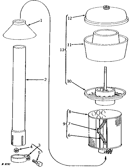

I need to remove the hood from the tractor but first need to remove the air cleaner stack, which I can't figure out how to do that, and I can't find reference to that in the service manual.
   / 3010 Gas Air Cleaner Stack removal #2
Take a dead blow hammer(mallet) and tap the bottom of the air pre-cleaner off the pipe. Then just raise hood off off muffler and air cleaner pipe at the same time.
   / 3010 Gas Air Cleaner Stack removal #3
on our 4010 you can turn the pipe and pull it out
   / 3010 Gas Air Cleaner Stack removal #4
Here's a parts schematic of the pre-cleaner for both 3010/4010 diesels.
