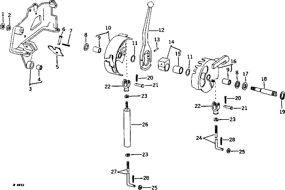

Diff lock valve is independent of brakes except for a diff lock release linkage attached to brake pedals. Brake valve sounds as if brake valve pistons are sticking which requires a kit and some cleaning. On trans sounds as if shifter or linkage rods needs adjustment or possible shimming. Latch(parts key 5) has a history of wearing therefore not holding one of the shifting drums in correct location.plus wear causes slack between drums requiring more shims(parts key 17)

Thanks again sorry for the double posting was not sure where it should go. I will check into the brake valve pistons, it's odd seems like the pedals are just stuck in the middle, cannot push them down or pull them up. On the transmission everything worked fine until I changed the oil but the dip stick shows full and the right side of the shifter mech works ok, just not the left. Thanks again and I will explore your suggestions.
