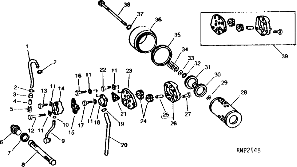

Easiest way to check stand-by pressure if tractor has rear remotes is to just plug gauge into rear breakaway coupler and activate SCV control lever. Yes hyd filter can be changed without loosing much oil. Filter is one of the cheaper parts JD dealer sells. AR75603 Filter Element ADD 7.96 USD
Checking sump screen requires an oil drain or a running shop vacuum hose inserted in hyd oil filler tube. Sump screen is located between hyd filter & rear axle housing on LH side.
Is loader valve teed into hyd system or plugged into rear remote? Does your tractor have Syncro-range or Powershift trans??
