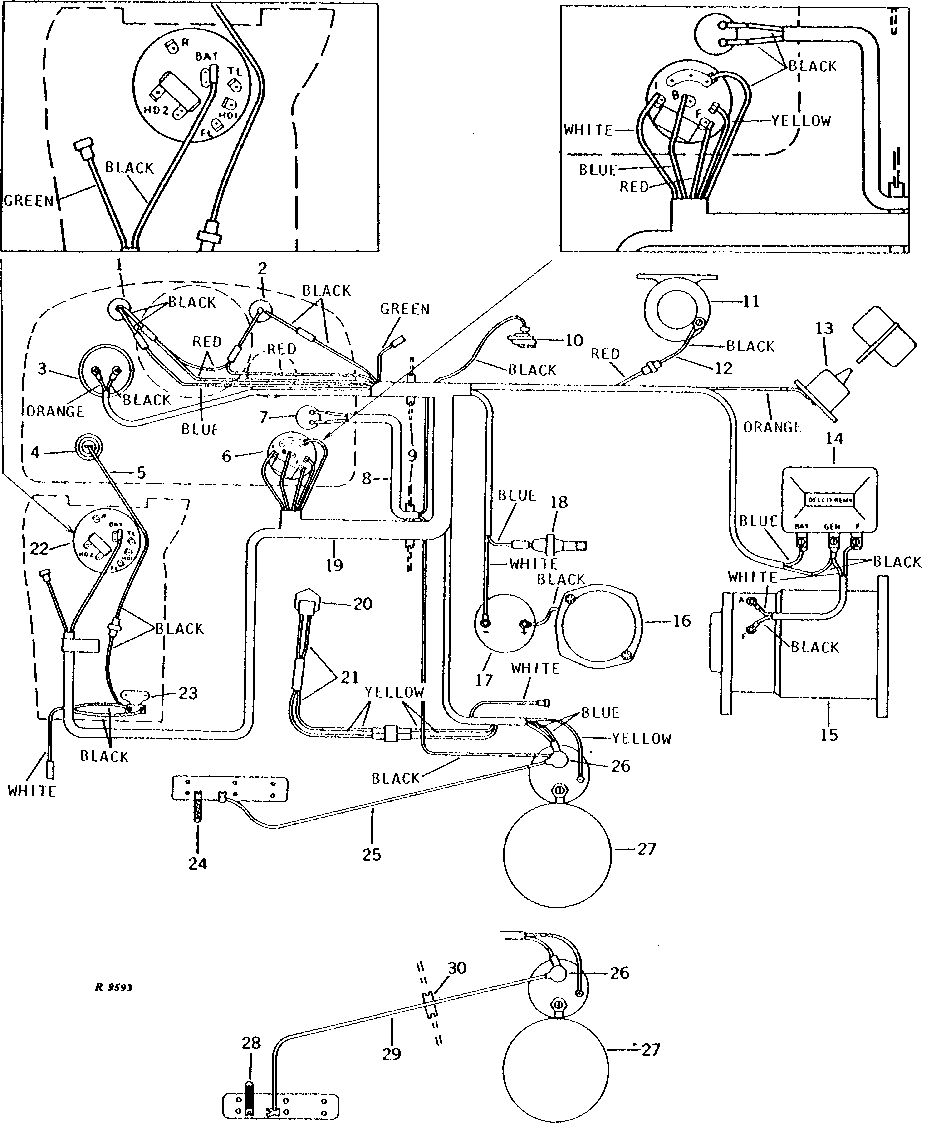

I was ripping up some corn when all the sudden my 3020 just died and gen light stayed on.....after monkeying with wires I jiggled shifter and it went off and fired right up, but to only do it again and now I can get anything to happen.............help please...ty

after checkin neutral safety switch found that it is something behind dash by key...

There's a circuit breaker(parts key 23) on the inside of dash panel that could be the problem

Thank you very much, would that cause it to just shut off while running fine? if I move dash panel while running I can get it to do it too......are you the one that told me how to free up frozen lift arm? Any knowledge on Leon loaders?
   / 3020 just quit gen lighgt on......... #5
Gen light should be on with the tractor not running.
   / 3020 just quit gen lighgt on......... #6
The circuit breaker that TxJim mentioned should only protect the light circuit. If tractor shuts off and gen light stays on(I assume it goes off when key is turned off), then the power to the key switch must be good. It sounds like you have a loose or broken ignition wire. Should be a white wire on back of key switch that goes to the negative side of the ignition coil.
