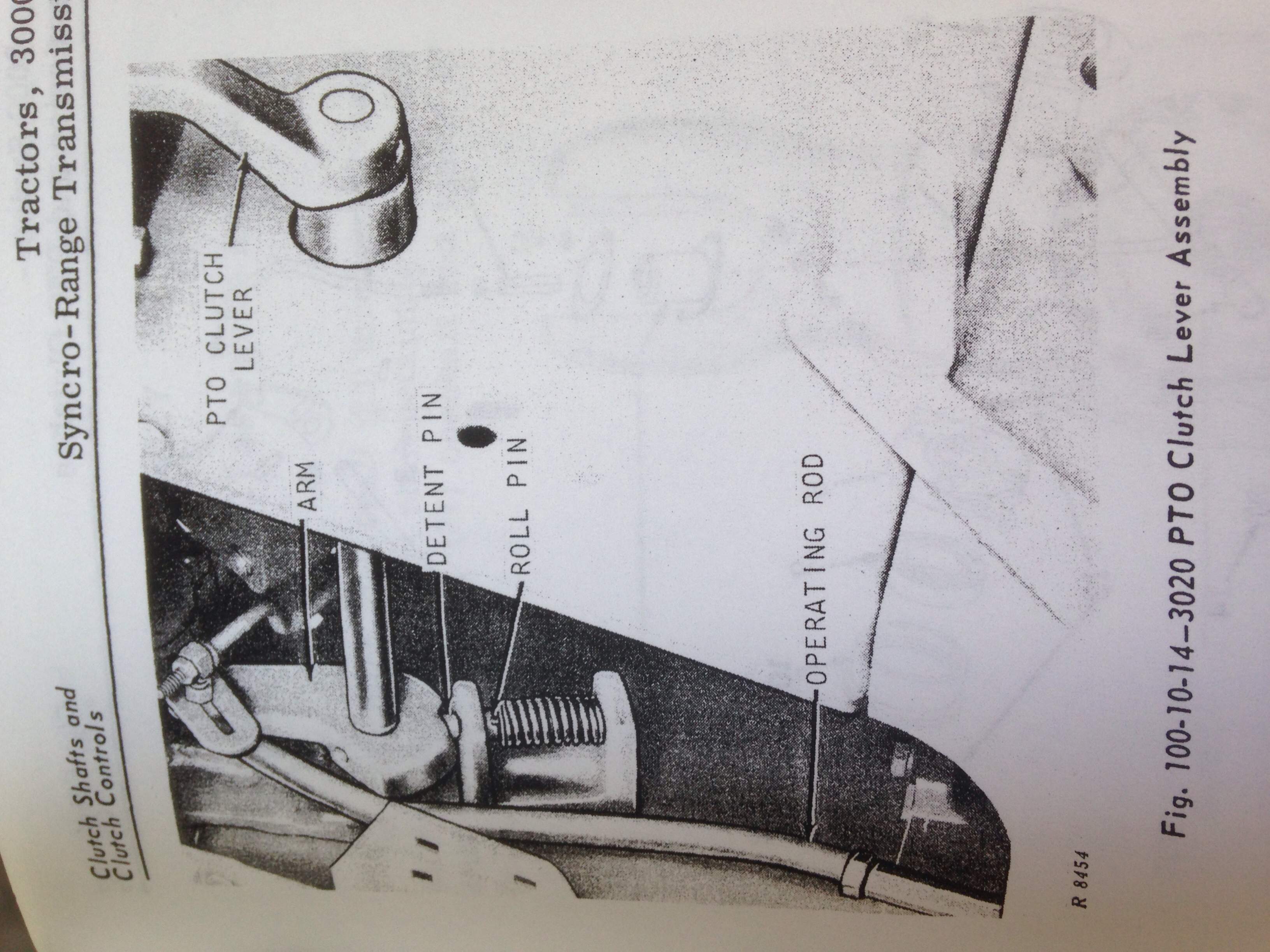

Was cutting hay yesterday and sounds like the PTO clutch is making slipping noises. I was wondering if there is any adjustments I can make to put more pressure on the clutch. Was thinking about shortening operating rod. Thanks.

The operating rod can be lengthend to apply more pressure on the PTO disc. You should check the PTO adjusting screws that they are even and one hasnt
come loose , remove the cover under the clutch assy and by turning the flywheel you can inspect the PTO operating levers.
   / 3020 PTO Clutch
Thanks for the info, didn't know that inspection cover was there. At first glance everything looks tight but there is an oil leak in there somewhere... Will be looking into more soon.
