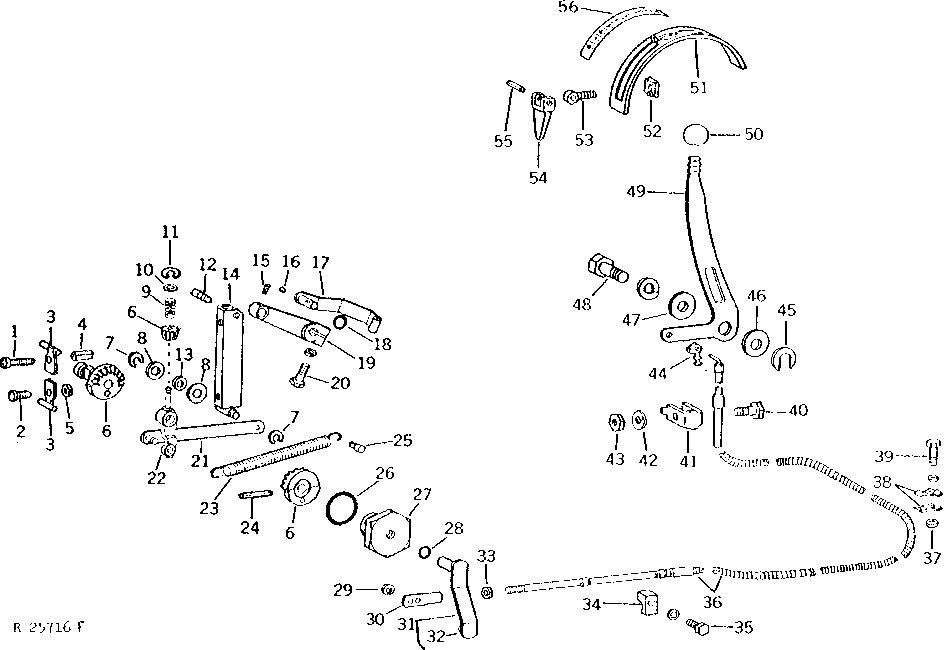

My tractor didn't come with a cable to control the Rockshaft.
I just bought a new one and in the process of installing.
I will be able to get it to work, but I believe the mounting brackets are no longer on tractor.
Could anyone take pics of theirs so I can see how they are mounted?
Thanks!
   / 3020 Rockshaft Controls #2
This parts photo is all I can come up with.
   / 3020 Rockshaft Controls #3
Clamp#34 bolts to the side of the rockshaft housing, just behing ght rockshaft lift arm. route the cable under the arm and clamp it in place with the 5/16" bolt. CLamp #410 bolts to the control support directly under the control lever. Should be a square 5/16" hole tha the bolt goes through and is secured with a nut.
